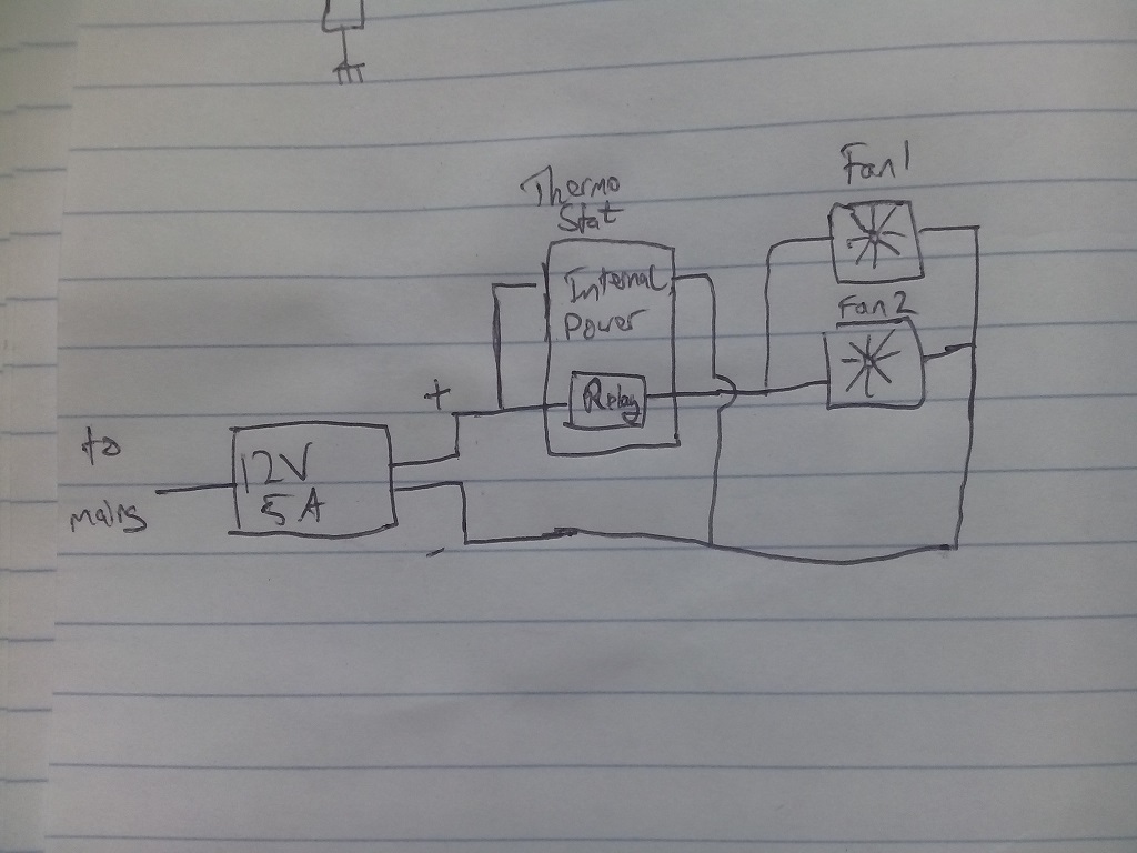

Hey Kris once again thanks for all the help.
This is probably the the finalised circuiting i plan to build. I'd thought I'd run it through you in case of any mistakes.
Below is the attached drawing I made of the circuit.
Hopefully you can read all that crappy handwriting :)

Obviously the relay and and internal power connectors for the themostat have clamp thingys so no soldering required. How would you suppose I connect the 3 way connection between the two fans and the relay output?
My crude solution would be to solder the two fan wires to the wire from the relay output. Also I would be using electrical tape to seal all these solder and exposed wiring so no one gets electrocuted, I'm thinking of using (http://www.jaycar.com.au/productView.asp?ID=NA2829) or what ever jaycart recommends.
Also with the wires, I will ask jaycart for single core ones that can wistand 150 degrees or so (the operating environment is with a oil heater. I might also buy some heat shrink tubing for the wires if they could possibly melt...
