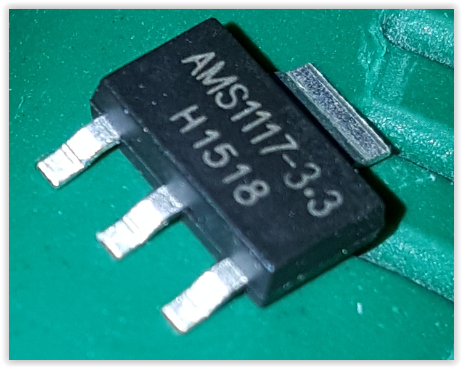

Hey all I am having an issue using this AMS1117-3.3 SMD:

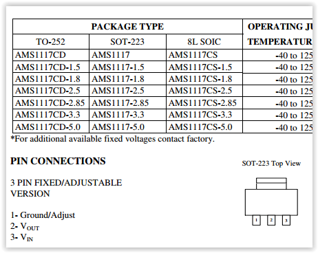

According to its documents it says its either a fixed or adjustable version? So I hook it up as I see in the documents:
The left pin (1) being Ground.
The middle pin (2) being the 3.3vdc output.
The right pin (3) being the 5vdc input.
Once I hook all those up, I test it with my voltmeter on 20 and i get a reading of 0.09vdc????????
I've already tried 3 of these to make sure I didnt blow it or anything but it keeps saying that readout.
Am I missing something here? This must be the adjustable version since I can not just hook it up and expect 3.3vdc to come out?
I also tried to just step down from 5vdc to 3.3vdc using 100ohm resistor but that only produced around 4vdc output....

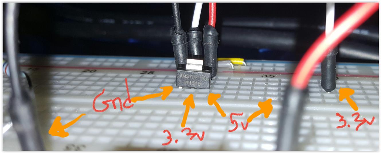

Here is the way I hooked it up:
The document I am reading is HERE
And also my breadboard:

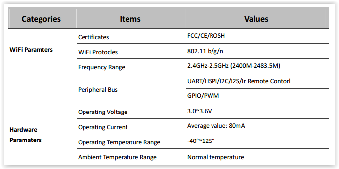

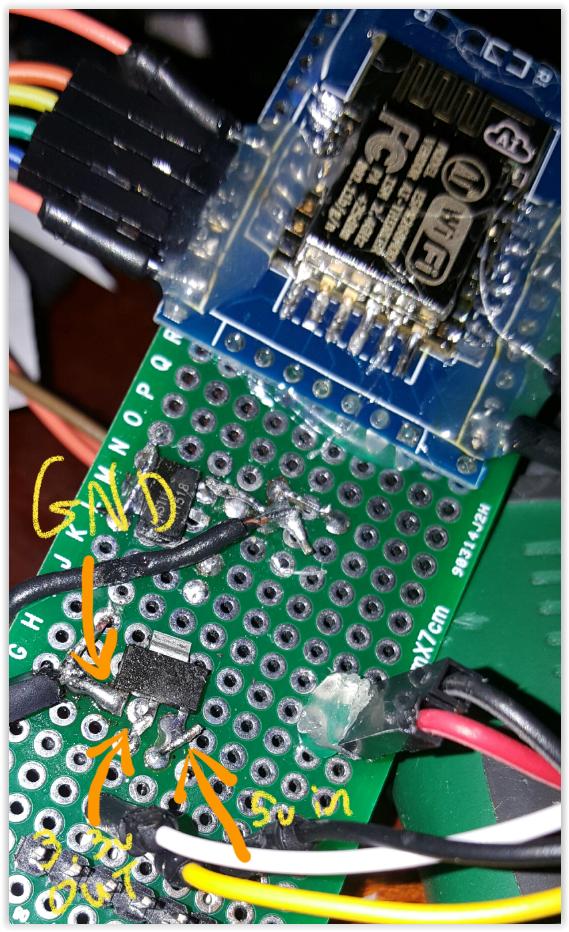

And what I have it connected to (ESP8266 ESP-12f) this is its document stating above 80mA average:

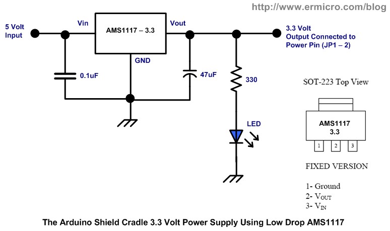

The -3.3 Version has a fixed output of 3.3 V. It is not adjustable.
You didn't use the required output capacitor (see datasheet, 'stability', figure 1). Your regulator possibly oscillates which shows as an erratic output votage in the DC range of your voltmeter.
Well, that's a fixed one. 1117-ADJ (or similar) would be the adjustable one.

Well, you should, but I note that you don't have either the input or the output capacitor as specified in the datasheet, and I'm not sure you can reliably push them into a breadboard and expect a good connection. Try soldering a short section of bare wire to each pin and pushing that in.
As an aside, I note that your soldering is a bit messy. You probably need to put in a little more practice.

I'd probably put a 47uF on both the input and the output. Having both a 47uF and a 0.1uF in parallel on both the input and output is best, but I doubt you'd notice the difference.
