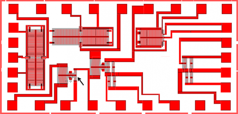

We fabricate a chip, a MEMS chip, mainly used for mechanical testing of nanostructure. The inner design of the chip is shown below.
upload_2015-3-18_10-28-34-png.80559

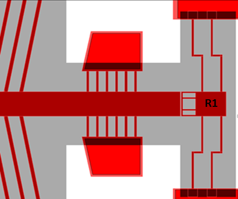

R1(250Ω) mentioned in first thread is the area which the arrow points at. Enlarged image is shown below.
upload_2015-3-18_10-33-57-png.80562
R1 mechanically function as a thermal actuator, it will oscillate under AC voltage.The aim of the experiment is to measure oscillation amplitude under different frequency. The part on the left is a fixed structure, it should always be stationary.

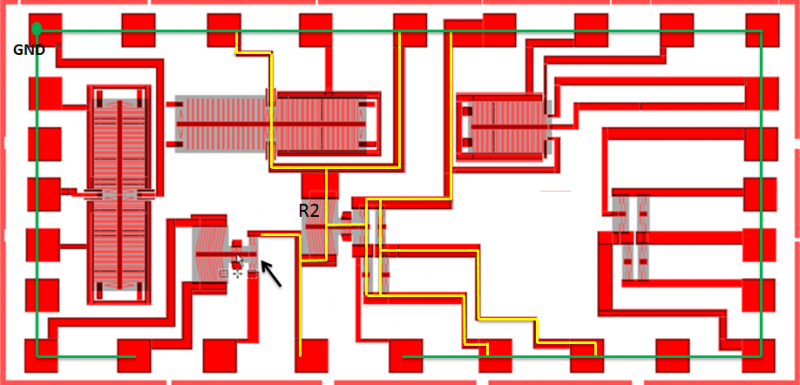

R2(500kΩ):
one end of R1 is also connected to other structures as I highlighted in yellow color. I simplified them as R2. All the pins are electrically connected(green line) using conductive tape, except the two pins through which the AC voltage is applied to. I connect the upper left corner pin to ground when doing experiment.

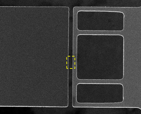

Below is the R1 under electron beam.
upload_2015-3-18_11-14-10-png.80584

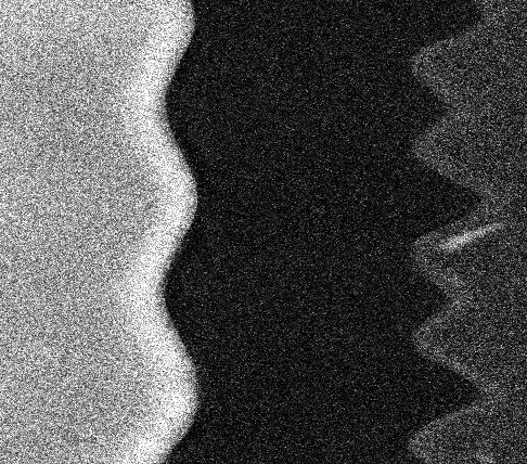

As I mentioned the left part is always stationary. But when I applied the AC voltage, I found the left part is also oscillating.
upload_2015-3-18_11-16-34-png.80586
I think the only reason is electron beam is deflected periodically.
If the electron beam is deflected due to magnetic field and magnetic field is due to AC current running through R2, then my question is AC current also runs through R1 and it is larger than current running through R2, then why the electron beam is not deflected in the second situation in the first thread?
