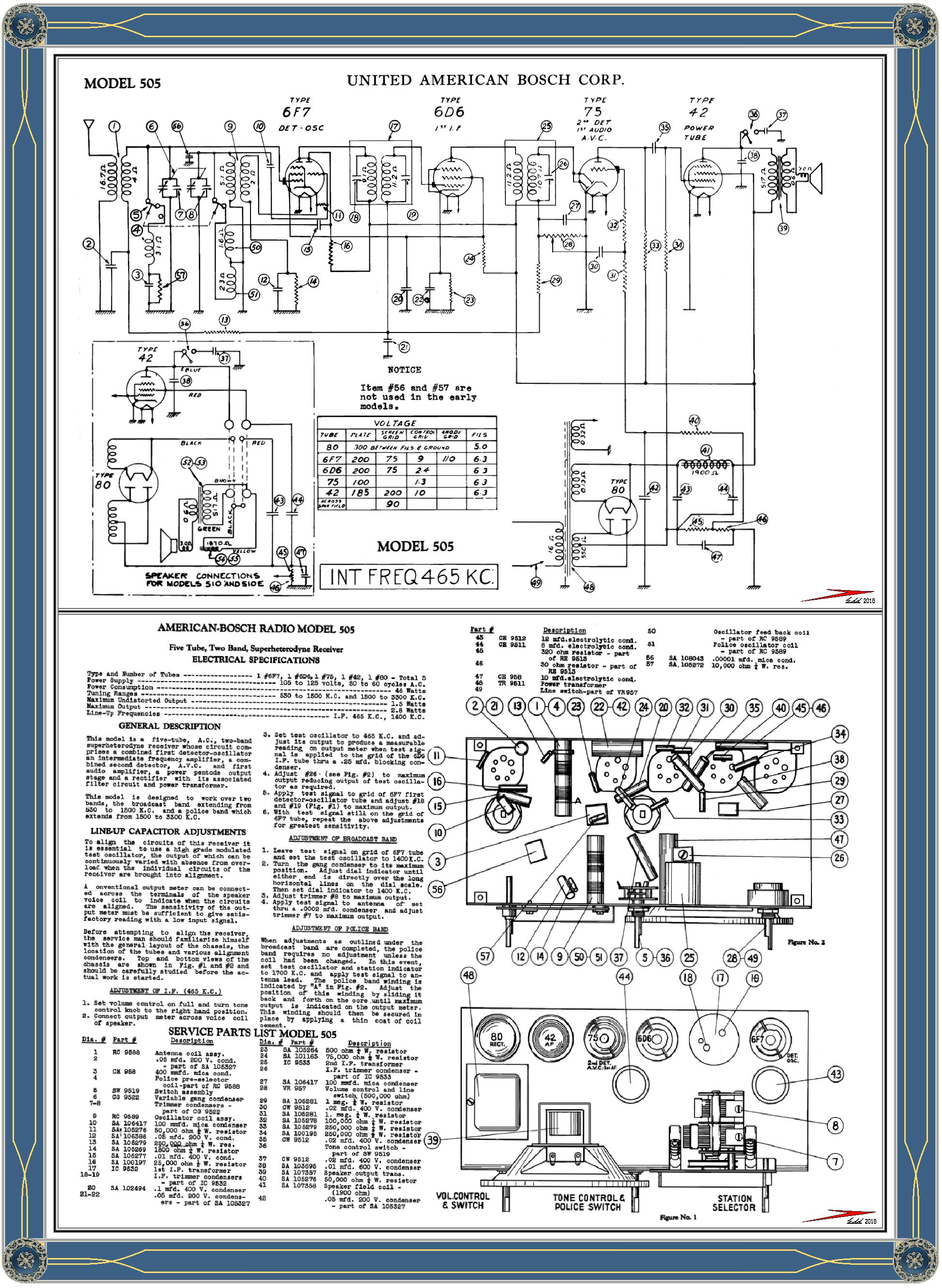

Trying to restore an American Bosch #505, as it has the best wood cabinet.
Electronic questions regarding the Micamold capacitors.
They appear to be electrolytic, but don't think they are, as the look like regular wax covered paper capacitors ?
They are labeled like this ".05 .05 " mfd. Why numbered twice ?
Also why are they metal strapped to the chassis ?
Thank you, Chuck.
there are probably two .05 caps with a common lead in the package
either for just mounting, it that is ALSO the common lead

Thank you. This restore is difficult for me because I have no schematic.
If this is a double capacitor, then the common lead will be the metal mounting strap to the chassis ???
This replacement should be easy, but there is another one in a very difficult area. Just one more question.
Then the common lead is chassis negative ??? I ask this to retain the proper polarity when replacing.

Sir Chuck Navajo1219 . . . . .
WOW ! . . . . . I just absolutely can't get any better referencing , than this, for you .
Obtained from a Riders manual # 6 of circa 1935 vintage and being in pristine condition with these two pages never having been opened onto daylight in 83 yrs.
Of course you'se got's to be initially somewhat Edd-ju-mucated, as you wont find a Bosch radio. You won't even find an American Bosch radio; instead, you have to fully know that they were known as United American Bosch at those early times.
United American Bosch . . .Springfield Mass.
https://www.bertibenis.it/images/American_Bosch/A_Bosch_1.jpg
I done a rapid set up and shot a hi-def close up, with a Nikon D-750 . . .24meg . . .babycakes !
That potential overkill lets me downgrade in density and definition later on .
I used my own, one off a kind, custom made wire frame "tripod" that mounts to the front of the camera and extends out 4 tempered wires to meet at the 4 corners of a square wire frame.That end frame just rests on the opened page of a book / magazine and the weight of the frame will hold the page perfectly flattened and at a precise distance. An opaque ring flash then provides perfect, non reflective lighting.
MICAMOLD caps . . . . .
I have seen MICAMOLD caps in those past 83 years in almost every type possible.
If one was molded into a .postage stamp profiled case using 6 dot color code layouts, and if the first dot was black, figure upon your having found a silver mica unit. If a silver dot, expect a paper cap in sheep's clothing.
Also I have seen electrolytics and metal bathtub cases with mounting ground tabs and multi sections.
Your provided info of dual 0.05 ufd units, is being a dual unit with one section providing AVC buss filtering and cathode bypassing of an IF amplifier stage.
Since you no give pics . . .we bring pics to you:
See which one is your unit(s) and report back, and we will fill you in.

THE SCHEMATIC . . . . .

Thank you , 73's de Edd, for the very most information on the American Bosch. Now I have a schematic of the set and can continue with the quest to restore this antique, very good cabinet, and somewhat electrically bandaged up.
Excellent coverage of the Micamold capacitors. I found a picture of the one that is faulty(I believe) that had puzzled me. It is a paper double .05 mfd, with a metal strap for the common lead which is soldered to the chassis.

That image was just absolutely perfect . . .UNTIL I had to submit it to my Image hosting site and you now can see the DREADED J-peg "crusting " aberrations that were introduced upon it.
But, had I submitted it as J-peg initially , they would STILL have to RE-J-peg it and the resultant double crusting.
But this MUCH more quality than one would get from Nostalgia Airs schematic site.
