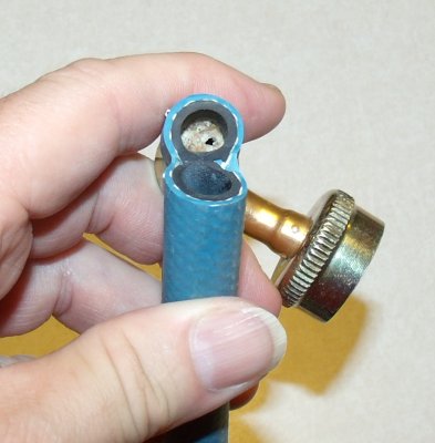

Update: it wasn't the solenoids at all.

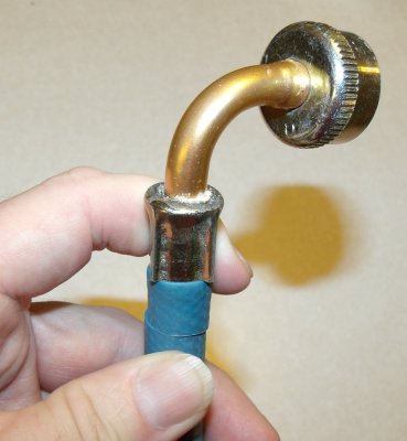

Back in August I took the hose off of the washer and found some junk in the inlet filter screen of the solenoid, but not really enough to clog it up much. It appeared to have improved the flow slightly, but not much. After that I hadn't done anything with the issue, as the washer was still working. The hoses were ~6 years old however and I normally did try to replace them every 5 years. When I finally got around to putting the new hoses on, the cold water line flowed like normal again.
After pondering this matter about a day I remembered that the elbow on the cold water line appeared to have some corrosion on it that the hot water line did not have.... So I cut it open, and...
A page link in case the photos don't show: http://beevilletrainwreck.com/assorted/hose/was_clogged.html
Ummm, yea, that might have been it.
I've bought these kinds of hoses for years (with the brass elbow on one end) and never had this happen before. <:p
I know that you get corrosion if you have two different kinds of metal fittings that touch in a water line, but that didn't happen here. The water solenoid body is plastic, and the washer hose is rubber. Whatever corroded was inside that elbow fitting???

So o o o o o o o . . . it was a water flow constriction.
Man . . .those are some dinky diameter hoses. Mine, on our Maytag, are more akin to the larger diameter of a garden hose.
