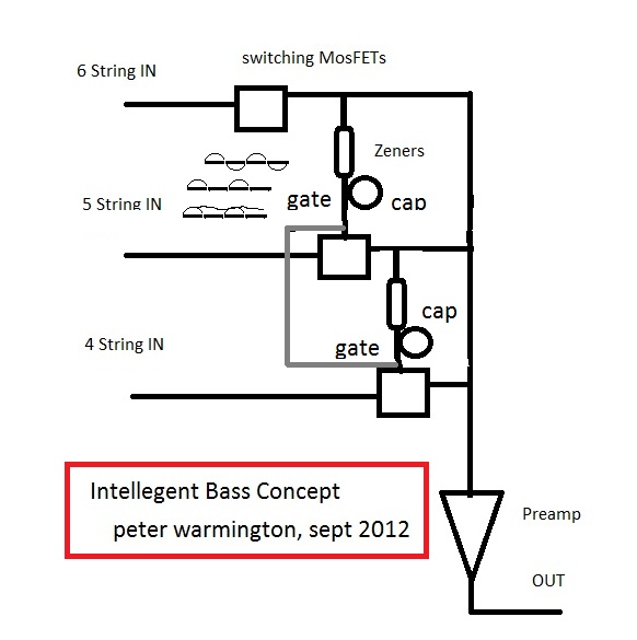

The idea is for sensor on the low 3 strings of a guitar. I have developed such sensors which are low impedance that can sense individual strings. The intention is to send them to an output and drop the signal by an octave using a pitch shifter or similar effect. A preamp to boost the signal will also be required.
The circuit help is required is about 'logic' for want of a better word. The end result is that I want to only have the lowest note of a chord sent to it's own output.
So if we label the sensors E6, A5, D4 for the low three strings of the guitar, low to high. If E6 is sounding I want this to turn off A5 & D4. If E6 is not sounding, A5 to out and D4 to be turned off. If lower strings are not sounding, I imagine there is no harm in leaving them 'active'.
So, any ideas to achieve this kind of thing. Needs to be low noise, simple and compact and low power requirements. My intitial thoughts are some kind of electronic switch, perhaps a transistor that will sense the incoming signal from say, E6 and turn off the signal to a preamp from A5 and D4...that kind of thing.

Interesting. Hadnt heard of this guy before. So basically what you're looking for is a fancy bass boost. As a guitarist myself I was actually looking for a similar sound but was thinking more along the lines of a custom neck with a few bass strings (alot of my stuff uses different tunings and 2 or more simultaneous melodies). I havent really experimented with audio circuits much since amplification is such a huge field with good sound being a fine art (but I still have a cool idea for a quasi-digital ringmod I want to try out one of these days).
Anyway, from a top level view, there will always be some crossover and / or accidental hitting of strings so its probably best to go by which of the 3 is sounding the loudest. Then again what if you want 2 simultaneously? In order to measure loudness, you will have to rectify and smooth the signal. Pass it to a comparitor set for your trigger level but give it a decent hysteresis gap since it will never be 100% smooth. From here the logic for determining the lowest should be simple enough:
( D4 AND NOT (A5 OR E6)) XOR (A5 AND NOT (E6)) XOR (E6) )
Use the logic output to switch the audio signal from each pickup - which brings up another issue: the sudden turning on and off will sound ugly so you can smooth this either with capacitors in the switching circuit for a simple fade or have some kind of crossover area (which makes things far more complicated).

Ok...well the 'logic' is not really hard, if the signal is coming from the lowest string E6 the other two are switched off creating a mono signal that will go through to a preamp and out to the processing and amplifier.
Now, you will have to hold my hand through the rest...lol
I was thinking of perhaps a compressor like circuit, something very simple and small. Something like a switching transistor on the sensors to be switched off, the gate triggered by the signal out of the lowest sensor. Perhaps a diode to filter out the appropriate side of the signal so it is only +ve or -ve and perhaps a cap that will keep that signal high between the 'dips' in the signal and smooth things out...if that makes sense. I am more of a concept guy and electronics I know a vague idea of how one might approach it, but not the details of designing the most effective way or other options. Like the idea of using a comparitor...you might need to expand on this for me...
You are probably right that some kind of 'threshold' will be needed, certainly careful playing technique to ensure clean triggering). I don't think it needs to be too complex, though I can be very naive in this, as this is not amplifying signals or in the signal chain, but a switching circut that hopefully wont (it cant to be effective) be heard in the audio.

I admit that I might be completely naive and this is a concept rather than a 'circuit'...but this is the kind of approach I came up with....troubleshoot and develop it, or alternatives welcome...
So, sensor E6, if there is a signal, has it's audio wave chopped by a diode so that only the positive (or negative?) wave charges a cap, that keeps the signal roughly above zero when sounded...this triggers the gate of a transistor on A5 and D4. Similarly, if no signal from E6, signal from A5 will pass, but will trigger the gate of D4 and turn that off. Any signals that pass goes to a single preamp for output.
As I say, may be naive in this kind of approach, but seems to make sense and might inspire better ideas or save me from following an impractical path...any help is appreciated in this...
Thoughts? Errors? Alternatives? Help with details?
