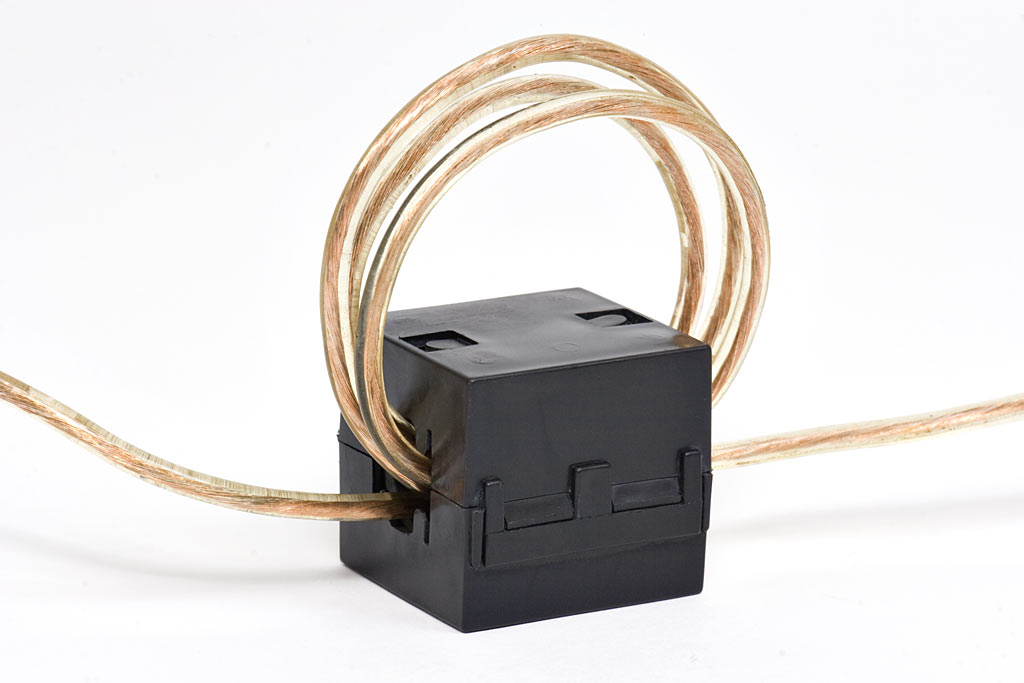

OK, at least we know we're not duplicating effort :)
My first try beyond checking filtering/decoupling would be to get some toroidal ferrite cores and wrap *all* the cables through them as many times as possible. See if this reduces the noise. If you're really keen you could do it one at a time and see where you get improvement.
Something like this:
Unless you can beg, borrow, or steal some, wait until we've looked at your circuit diagram. There may be other things to try as well (or even before you try this).
Thanks, I will try that.
