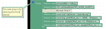

ESP8266 or ESP32 and Tuniot.
A general Tuniot example :
To get at net time the blocks to use are :
Tuniot does not have net time block specific, so one uses Arduino code example and using the
Tuniot block "Arduino code" loads the Arduino code into it. So a general Arduino type net time
solution can be configed into block form and run by Tuniot.

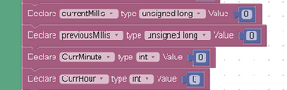

Note at Tuniot website there are basic clkient server examples for templatys, here ios
the server one that you can build from :
Regards, Dana.
