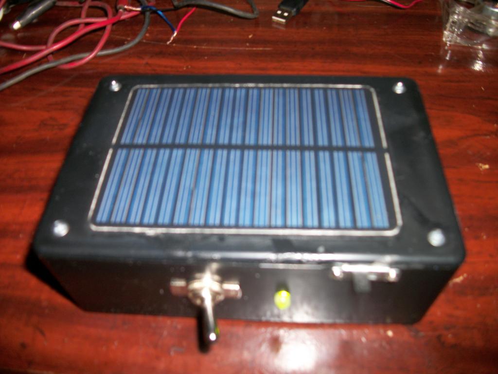

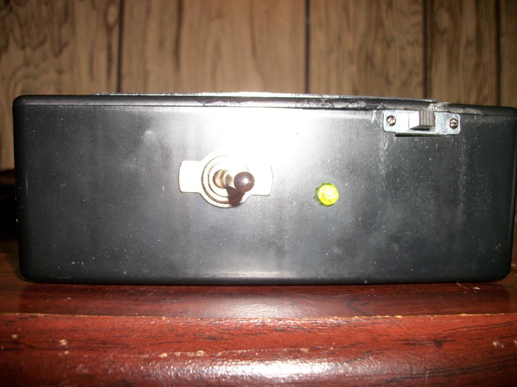

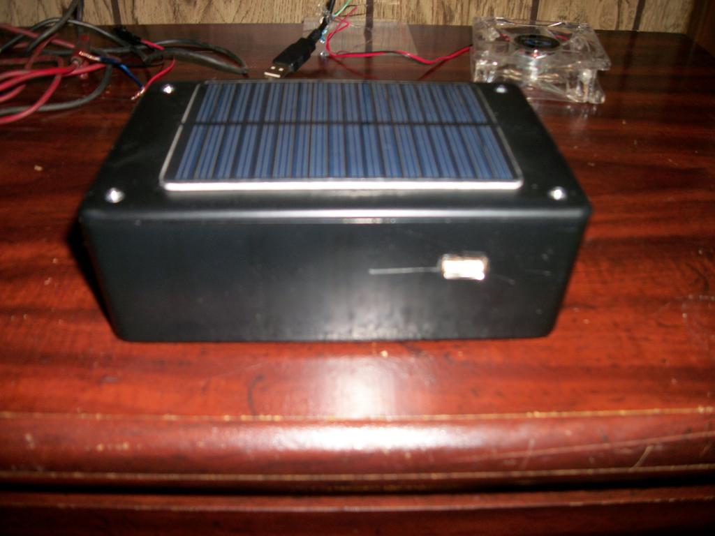

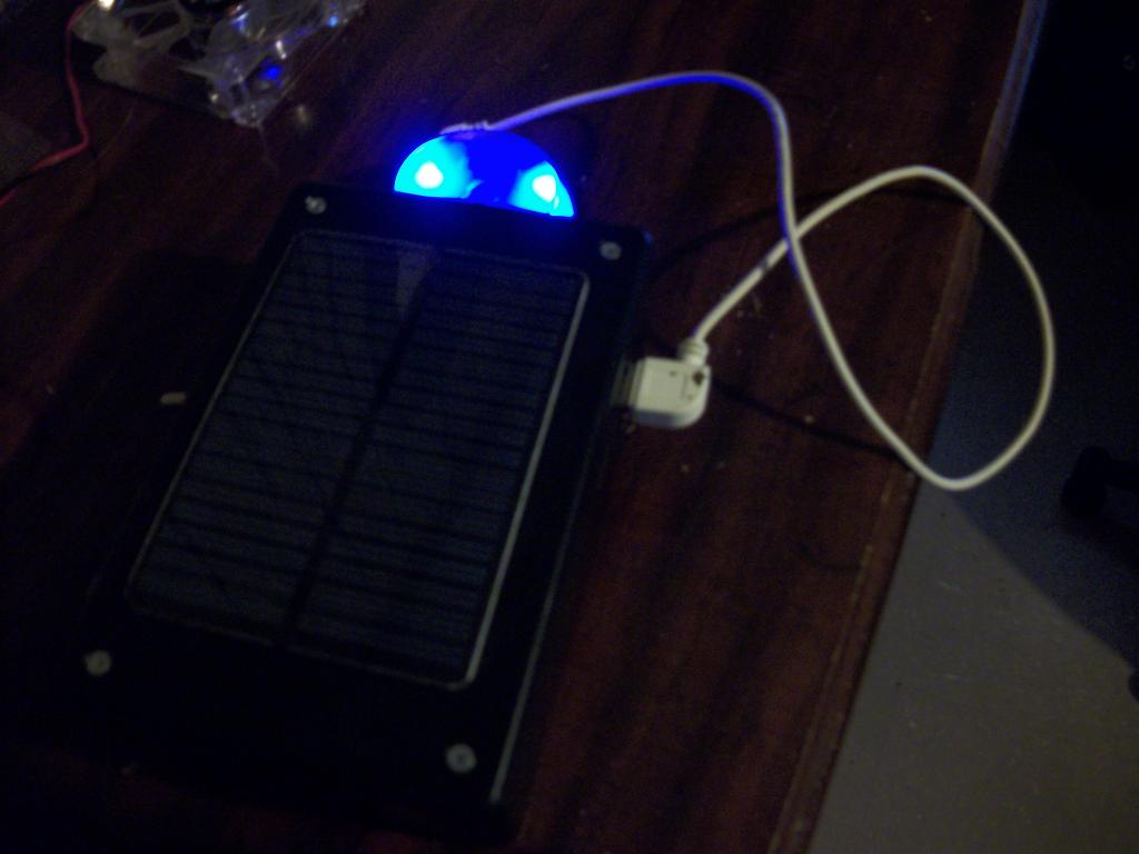

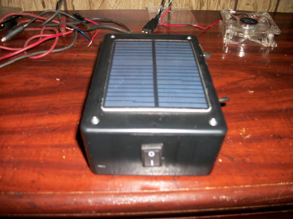

Project Done
I thought I would upload some photos of the finished project!
It doesn't look perfect, but it works!
donkey
Feb 26, 2011
1,301
Feb 26, 2011
1,301
nice. just one question, why did you not use a dpdt?
you want to turn of the led and circuit at once, the LED will be an indicator showing the circuit is active and the battery has some charge so having it on at the same time as the regulator might be a good idea.
