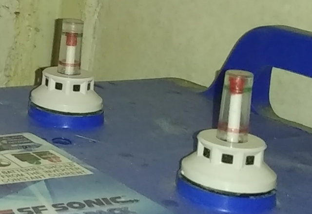

Hi,
I recently topped up my 12V 150 Ah Inverter battery with distilled water. Due to corona outbreak and 'lockdown', the service engineer who normally does this was unable to visit my place. I had battery distilled water bottles with me and indicator had reached the red line, so I topped it up.
Since I am inexperienced, I had to keep on doing pouring,closing,checking level and repeating this until the floater reached the green line. However in one or two instances, the water level indicator is now above green line. However not even a single drop spilled outside when I closed the lid.
Here's a photo. The front indicator has crossed the green line.
Would this matter in any way? Is it safe and normal?
Later I tested the Inverter by tripping the mains circuit breaker and it worked just fine.
Thanks.

I think you are okay on the very slightly overfilled battery cell, since you didn't spill any battery electrolyte while adding distilled water a few drops at a time. And you did the right thing by not allowing the electrolyte level to fall below the red line. The battery plates must be covered with electrolyte at all times to preserve the life of the battery.

I agree, your fine.
It's worth noting that the water level varies depending on the charge the battery holds.
Typically you water when the battery is fully charged and you top off the cells to the full mark.
If you were to top off the water level on a discharged battery it would overflow acid when its charged.
If you want to check the water on a discharged battery, it should slightly cover the top of the plates or be above the red mark on your level indicator.
