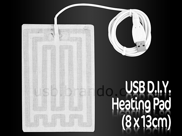

It's ok it all sounds too risky and involved now, I just wanted a simply project without dangers or complex equations to solve, one I could test as I went along and work it out as I go more as a learning experience starting with very low power multimetre and aa testing.
I did read a beginner electronics book (except for the projects at the end) and it didn't have warnings of serious dangers with aa battery powered testing so I feel a bit stupid now. I'm working on a passive solar design with a black container instead and for the other warmer design I'm just going to buy a ready made usb powered warming module. Anyway the nichrome wire would have never suited my purpose anyway it's the wrong type of material being so thin and massless and also not suitable for my basic level of understanding. It looks like it's more suited to bar heaters etc. which I have no interest in making. I just want a gentle warmer pad not a 500 degree danger wire.
Voltaic
May 6, 2015
82
May 6, 2015
82
So this is the sort of thing I wanted to make (but spread out over a slightly larger area) but I'll just buy one, it's not worth the trouble trying to try to make.
Definitely not this
