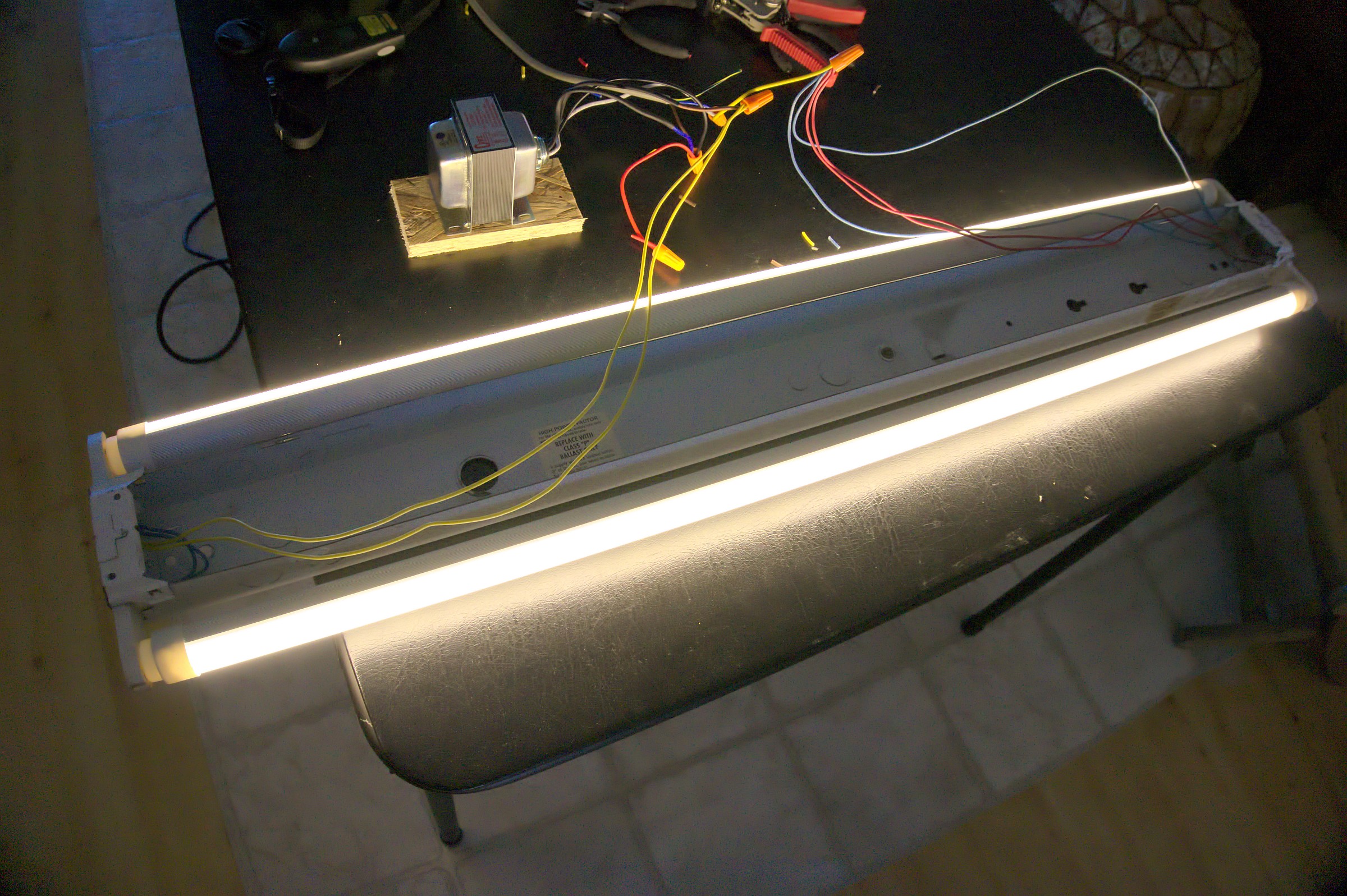

I have a project that requires 3ft florescent tubes and I've purchased some 3ft T8 bulbs for the project. These are hard to find apparently, and my bulbs came from China.
http://www.bestlightingbuy.com/3ft-t8-led-tube.html
They say they operate on ac voltage from 85 - 265, but they don't work at my house with my 120.6 Volt power. I have a Kill a watt and I carefully hooked them up with a Variac and they operate perfectly at 126 volts or above, but below that they blink at about a 1 sec rate - apparently saying that the voltage is wrong. The Kill A Watt and the Variac give me confidence in my conclusions.
So, after getting 4 of these bulbs for about $100, I need to boost the input voltage to use them. They apparently come from China and I can't really find others at a reasonable price so returning them is not really an option.
Can someone help me find a transformer to boost the voltage from 120 to about 130 to run these bulbs? If they operate up to 265, I'm not worried about too much voltage, with in reason. But two bulbs pull about 30 watts, so I'll need a transformer that supplies about 40 watts to be conservative. Obviously, purchasing variacs - I saw a small "cheap" one for $121 - is not viable. I'd like something in the $20 ballpark. I need two transformers, each to run 2 of these bulbs for my project.

You could purchase a low-voltage transformer, commonly called a control transformer, such as the one shown at the link. Wire it up as a "boost" transformer with the secondary in series with the "hot" side of the power line and the primary connected between "hot" and neutral. You need to "phase" the secondary winding properly with respect to the "hot" mains feed so the transformer voltage adds to the mains voltage Get it backwards and it will subtract. Secondary current rating should be at least as great as the lamp current.
Transformers used this way are also sold as buck-boost transformers, presumably with better insulation between the secondary and primary windings, since the secondary is "floating" at the mains voltage. Buck-boost transformers (sold as such) tend to be a little pricey IMO. But Google "buck-boost transformer" to see what is available.

Thanks much. Looks like exactly what I need at a very reasonable price. I'll get a pair and give them a try. Using the variac and Kill A Watt it should be easy to figure out if the phase is correct to boost rather than buck. Yes I see the standard "Buck-Boost" transformers. They seem to have higher ratings, like 500VA, and look like they are meant to conform to house or industrial wiring standards rather than hobby project wiring practices. I understand that anything that pulls 40 VA is not strictly a "toy", but these look like way overkill for my simple project. Again, my testing methodology should keep me safe as I make sure this works.
Thanks again.

Just got my transformers and looks like they work fine.
I'm running them for a few hours and monitoring the temperature of the transformer.
Thanks for your help,
wp
