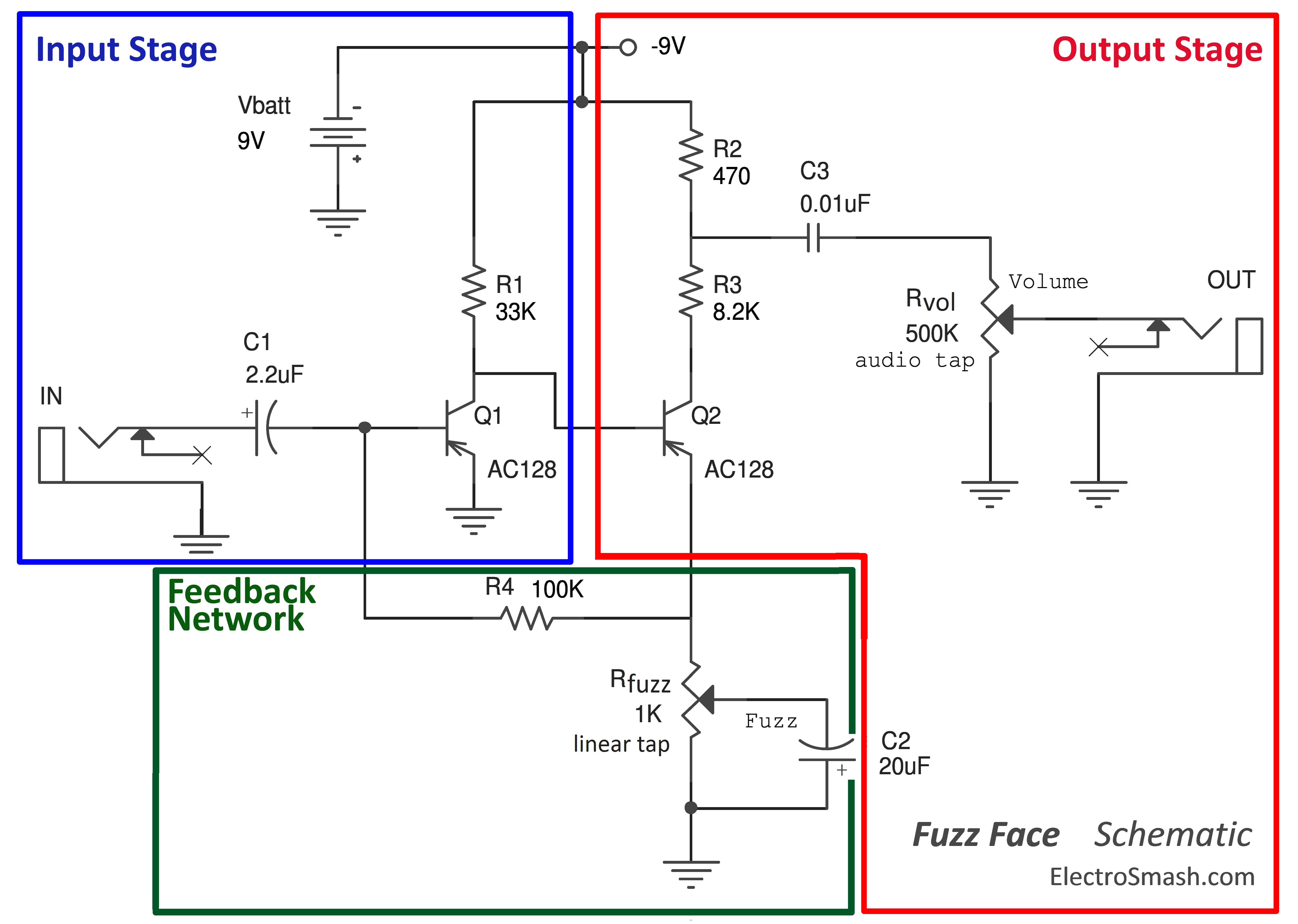

I'm kind of a newbie with electronics but I do know how to differentiate the two generally. But in this there aren't any of the common markers. If I had to guess it would be NPN but I can't be certain. If someone more experienced could help me out that would be great.
Also, if there are any guitar pedal guys out there, does the pot control the overall fuzziness of the circuit?
Thank you very much (all help is appreciated)

What at terrible circuit diagram.o_O
No need to guess,the Emitter-arrows point inwards ==> they are both PNPs.

Here's the original 50 year old circuit

Just like on a map, the arrow points to N.
on the transistor symbol, if the arrow points out, it's an NPN transistor (because the N's are on the outside). If it points in, out must be PNP.
on a mosfet or jfet the arrow also pointed to N. Pointing inward, it must be an N channel device, so pointing out means P channel.

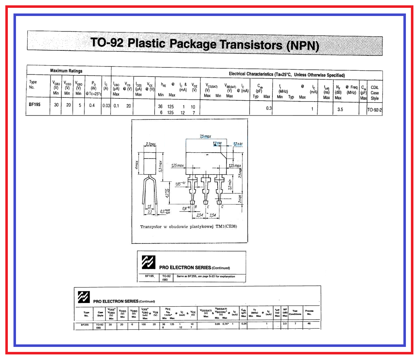

Hi I am very new to electronics, I am using a BF195 transistor, and I am not sure which pins are the base, collector and emitter. I have looked for schematics' online but can't find any. I am pretty sure it is an N-P-N. Please help. Many thanks in advance. Regards Nick

Sir Nicholas MacNaughtan . . . . . . .
Had to dig thru ye olde design reference library for that one . . . .
From the words uf der Katzenjammer Kids . . . . . .
Ahhhhhh chesss ve dun just bin gettink in und fresh 'chipment dis mornink . . . . und vud you be wantink vit der left handed or der left handed vershuns?
Und vud you be wantink schmidt der clockwise electron flow fer der norths uf der equator . . . ..or fer der counterclockwise electron flow fer der souths uf der equator ?

The connections of various transistor differ. Sometimes the collector is in the middle, sometimes at the end. You will need to look up the data or measure the transistor for gain.
Note that just to confuse, some transistors of one type have a different connection layout, these may be labelled with an L after the number.
In this manufacturers cases point of reference, it is being the 45 degree slope, that's notching off of the whole top corner, above the collector side of the transistor.
