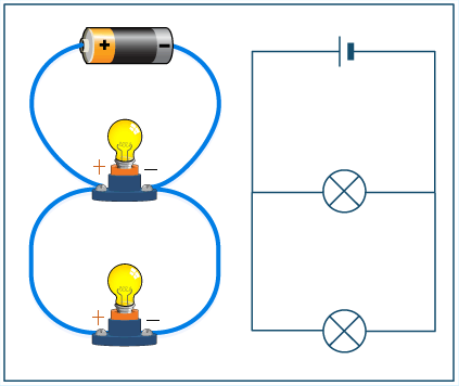

Hallo everyone!
I was really curious about circuits in parallel and series...
I understand how things work in series..
But is a demonstration of a circuit in parallel:
Now as you can see there are two light bulbs that are functional in the circuit, now what i want to get my mind around is the "power input"! If there is an input of 6volts at 1 Amp which is 6Watts total...
In parallel will the light bulbs all get 6watts of power? In the diagram there are only 2 light bulbs what if i had 10 light bulbs? Will the 10 all get 6 watts still?

Yes, but if there are 2 bulbs that 6W is 3W each. If there are 10 bulbs, that 6W becomes 0.6W each.

In parallel, all components "see" the same voltage. In the case of a resistive load the current through each component is defined by I=U/R. So each load "takes" the current it needs.
In the case of other, non purely resistive loads, in detail things are more complicated, but the same principle applies: Assume that the load is rated for the voltage Vnom as is used in the circuit. Further that the load has a rated power Pnom (and at this point we don't care whether it is resistive or not), the current Inom will then be Inom = Pnom/Vnom.
This applies as long at the voltage source can supply all the current drawn by the loads.
A common misunderstanding is that the power used in the circuit is not defined by the power source, but by the load. The power stated on a power source is just the limit of this source, what it will be able to supply without degradation.
So if a power source states e.g. 5V/1A, that does mean that it can supply up to 1A while still regulating 5V. This does not mean, however, that the power supply will force 1A through any circuit attached. If the circuit (e.g. a charger for a cellphone) requires only 0.5A, then 0.5A will flow.
The basic rule is:
Parallel connection: same voltage, different currents.
Series connection: same current, different voltages.
