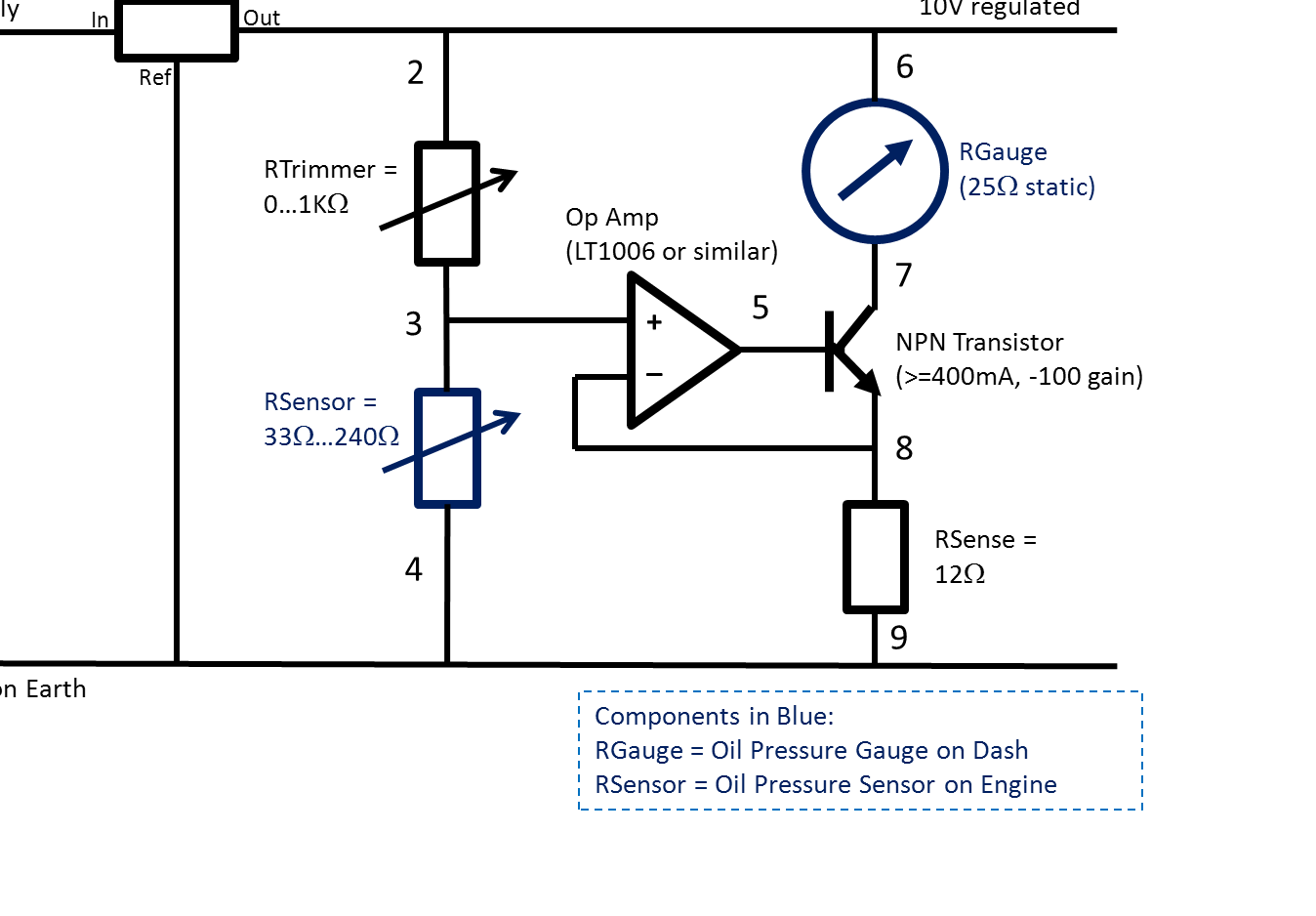

rockrockmcrock
Dec 19, 2011
41
Dec 19, 2011
41
Thanks Harald - sadly I'm on my own with this. My mates are losely split into three camps - those that have no technical interests, those that understand everything there is to know about cutting-edge information systems & security and those that are magic at welding, testing oily coils & dynamos and rebuilding old engines....
I am however a fast learner (usually) - so please don't give up on me!
Usually, I need to understand the 'how' of things before I get them right. So I did some self-learning this morning online and hopefully now I am on the right track (see below) - but can I check my understanding of the 'how' it works with you? Also there are some specs - particularly around selecting the right Op Amp that seem confusing to me at present, so any help here would be appreciated!
So here's my understanding of the above circuit and how it works (I hope I'm on the right track):
  • Voltage regulator produces 10v & up to 1A (easily enough) at 2 & 6 for 10v rated gauge and RSensor
  • Voltage divider (2,3,4) effectively inverts RSensor output, by producing a voltage at 3 which is proportional to RSensor resistance (i.e. increasing RSensor resistance, increases voltage at 3). RTrimmer can be used to vary the sensitivity for the op amp (ie "high-low" voltage change delta - is that correct?)
  • No current is carried across the Op Amp (3,5), this is the need for the second circuit 6,7,8,9 - the voltage at 3 is simply used to proportionally vary the current across 6,7,8,9.
  • The Op Amp triggers the NPN transistor to control the current and the feedback loop 8 to the Op Amp provides the reference input to the Op Amp (comparison of 8,3).
  • To ensure the right current in 6,7,8,9, RSense is used, such that current across RSense (8,9) must equal current across Gauge (6,7). Does this mean I need to know the resistance of the Gauge (Load) though to be accurate?
OK, assuming I'm not completely wrong about the above - any advice on the following hugely appreciated:
  1. NPN Transistor needs to carry the current and be triggered by a low current - hence a high gain, 400mA+ specification is ok?
  2. The Op Amp - there seems to be loads of variables to consider here....totally confused at present, but slogging on! All help appreciated!
Thanks again
RRMR
Harald Kapp
Nov 17, 2011
14,317
Nov 17, 2011
14,317
You have a very good understanding of the circuit. A few details:
Your image shows Rsensor from 330Ω to 240Ω. Shouldn't that read 33Ω to 240Ω? With 330Ω to 240Ω the circuit will not work as expected.
Actually there is current flowing from the output of the OpAmp into the base of the transistor. But insofar as the current through the gauge is concerned you're right. The OpAmp does not drive the current through the gauge directly.
No, the current source will try to drive the current as required through the gauge regardless of the gauge's resistance. This has its limits, naturally, as the product of current and gauge-resistance cannot exceed 10V (Rather obvious, isn't it? This is called compliance voltage of the current source.)
This sounds reasonable, although high gain is not of the importance. A gain at ~100 will suffice.
In fact for this application not many parameters of the OpAmp are important. Mainly that it is suitable for single supply operation and input as well as output rang near ground are required. An LT1006 may be used, although quite a few other OpAmps would meet these specs, too.
rockrockmcrock
Dec 19, 2011
41
Dec 19, 2011
41
Thanks Harald - you are correct and I've now altered the circuit diagram accordingly. OK - now I just need to source the electronics and a sender....exciting! Watch this space.....
