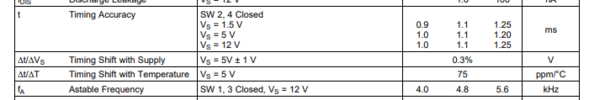

Now this is what I call serious accuracy (LMC555) :
And guess what, thats for a precision ideal timing cap placed on it.
Let me know where I can get some of those :)
Initial accuracy with an electrolytic at just room T probably around +/- 50%.
Dont hear of too many 555 timers in space applications......or life support medical......

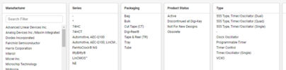

Lastly the tolerance on Alum Electrolytics, look at the tolerance column :
Regards, Dana.
