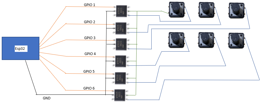

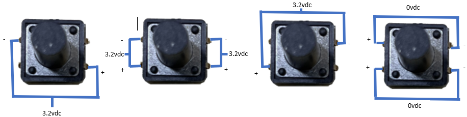

Hey all I have 6 buttons that have the following voltage:
enter image description here

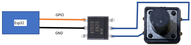

I want to hook up a 4N25 to each one of these so I can use the ESP32 as a "virtual push" to each of these buttons. When the button is pressed the 3.2vdc goes to ground.
To minimize the amount of wire going to each one I have come up with the following:
Is it possible to just hook 1 of the buttons left/bottom pins to all of the 4N25 chips so that I don't have to run 2 wires per button? Or is there a better way of doing this that will minimize the amount of wires?

Adding to the above, looks to me like you are shorting out the 4n25 internal LED (ok...but) you have no current limit resistors.
Likewise for the open collector unless you intend to use software pullups.
All seems rather unnecessary....please supply a complete circuit diagram and the code. (no fritzing stuff thanks)
