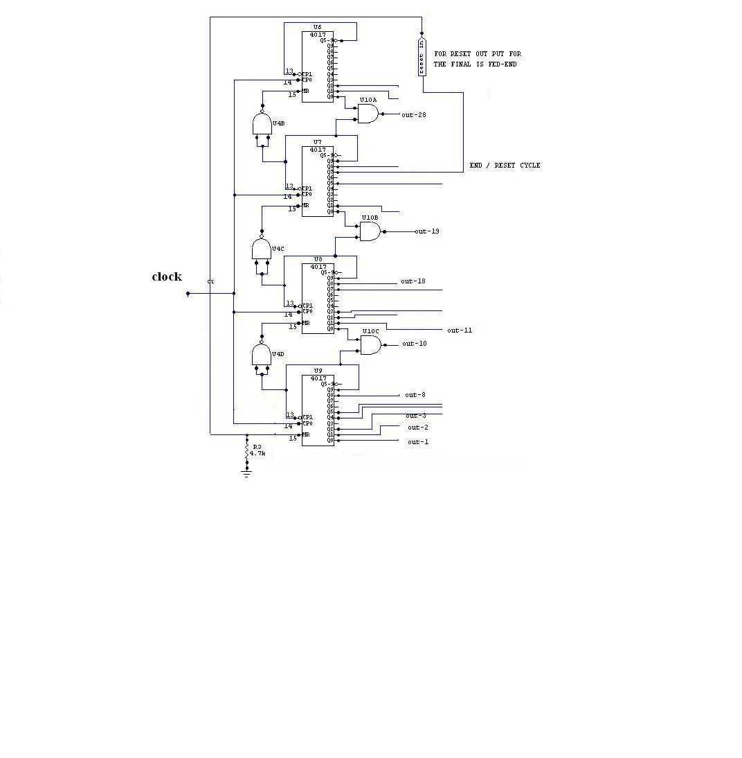

Connecting LED's to 4017
Hi there, I'm building/designing my own Electronic Roulette Wheel using a 555 timer with 4017 decade counters with 37 LED's.
I'm currently trying to cascade multiple 4017's using this schematic shown...
http://tinypic.com/r/b8juxw/5
I'm not sure I understand this schematic too well, I can't figure out where the LED's would connect to? Do the connect to the pins on the chips? or the AND Gates?
If anyone can understand this schematic more than I and can maybe explain it a little that would be hugely appreciated.
I know I'm asking for a lot here but I'm really stuck and can't move forward with my project without understanding this schematic.
