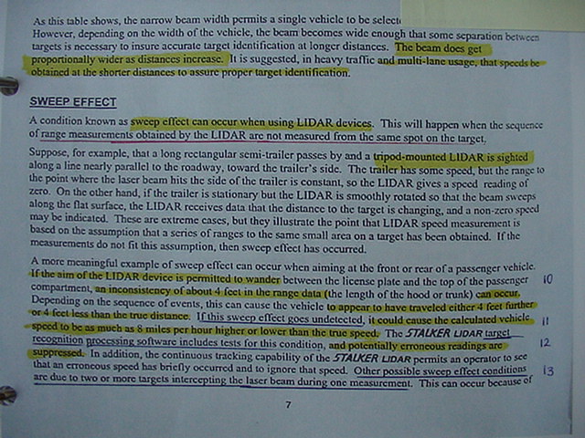

www.google.com/search?q=lidar+license+plate from what I could find the reflective plate is what makes it most effective.
"The LIDAR system is extremely accurate due to the fact that in order for the gun to read a vehicle's speed, the laser it emits must be aimed directly at the driver's license plate," Gresham said. http://www.malmstrom.af.mil/News/Features/Display/Article/825542/lidar-systems-back-at-malmstrom
Look at this
"It is possible to legally beat the police speed radar and/or lidar by spinning a wheel of mirrors on top of the car slower than the actual speed of your car.
partly busted
Tory’s “Wheel of Death” actually tricked the radar into thinking the car was going one or two miles per hour slower, but not enough to help. The device itself was highly impractical. Unlike the rear-view mirror attachments, the roof mounted device was actually not illegal.http://mythresults.com/episode18 "
That is similar to my idea of moving the reflective surface.
More http://www.quattro123.com/Stalker.htm
