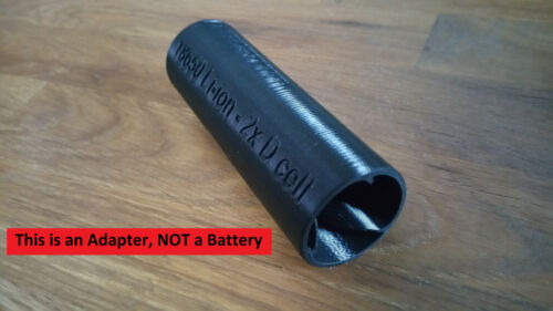

You can get an 18650 (lithium) cell to d-cell converter here:
Get a pack of 18650's and a fast charger and you're away...
