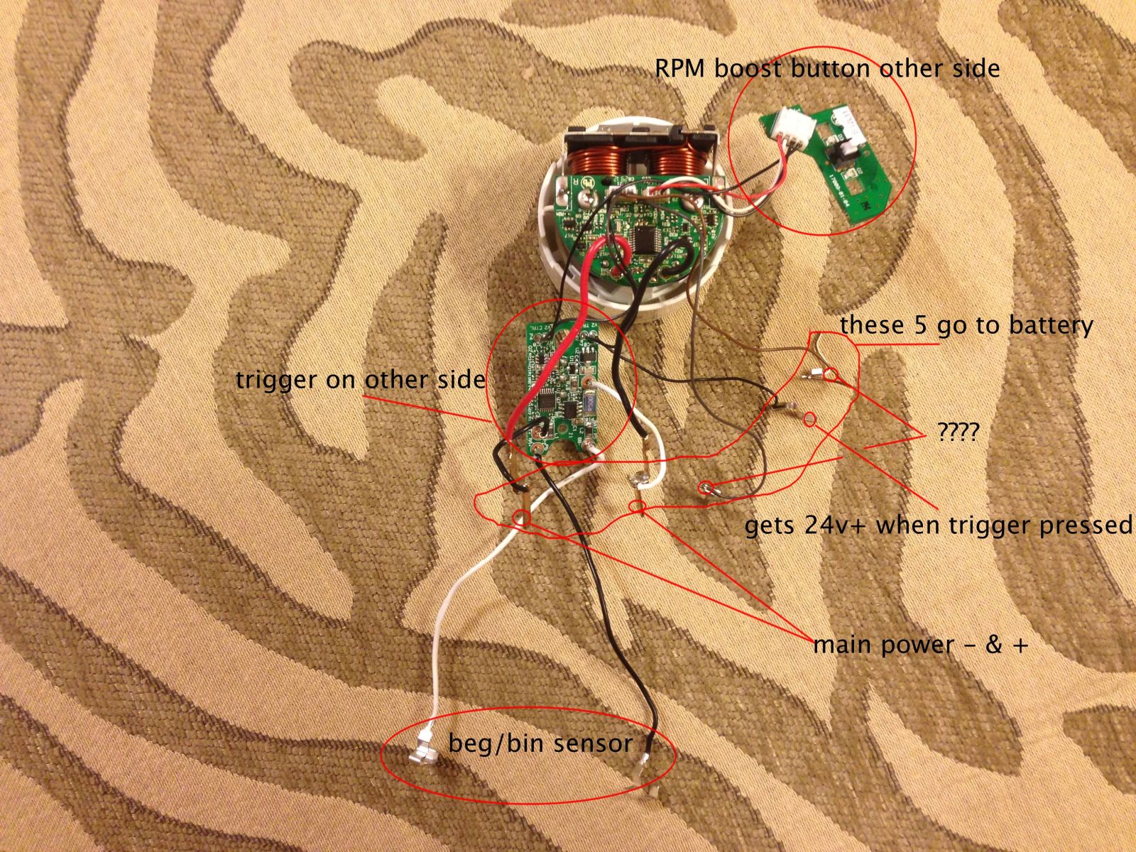

Bought one of their 95k rpm digital motors, took it apart but can't seem to figure out how to run it off an external battery.
Hole where the Dyson OEM battery pushes in has 5 wires/connectors. 2 large ones which are the main POSITIVE and NEGATIVE terminals and then it has 3 small ones. These 3 small ones I can't figure out what they do or how to connect them so I can run the motor of a car battery.
I'm guessing they are to check the batteries temperature, but for a thermistor you only need 2 wires, so still why 3?
Can't seem to find a wiring diagram for this motor anywhere, anyone have any ides as to how I can figure this out?
PS I don't have a dyson battery, wish I did it would make it easier to figure it out.

Yes sure we they are. There are 3 motherboards, bottom medium sized one is the trigger, one on the motor is the main board, and small one at the top right has a switch on it you push if you want the motor to speed up from 35watts to 70watts. Its like a boost button.
There is actually 7 wires in the pictures. two very bottom wires is just a sensor to make sure your collection bin is on the vacuum cleaner, it think it just needs to be shorted together.

I did find one of my problems though. One of the IRFH7932PbF MOSFETs in the motor H-Bridge was blown. A hole was actually brown through it, as shown in the photo attached. I will order a few of Aliexpress and see if replacing it makes any difference. I dont believe that this is my only problem, as if this had blown as a short across the 24v supply it would have pulled the voltage of the battery pack down, which didnt happen when I was measuring it. If it had blown as an open circuit, The charging and power LED would still be lighting.
untitled-jpg.29235
The second problem that I found was that I was connecting the two "beg/bin sensor" wires as identified in your photo above together. During my tests, I figured that they were connected to a normally closed sensor switch on the dust bin. From looking at the bin, they are actually connected to two terminals on the hose for powering external brush attachments. Im surpised that I didnt short out the battery pack by shorting them.

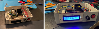

Hello, even if is an old post…
I have done it!
Look at https://forum.allaboutcircuits.com/...-dc35-multifloor-vacuum-cleaner-motor.196261/ for a complete study of that motor and how to control it.

Perhaps you have done it.
Was it done well?
Why do you say "perhaps"?
If you read the thread I linked before you can see the entire study sequence, from start to the end.
But if you prefer, you can just jump to the last page and see the finished controller.
Some screen:
Controller - breadboard test
Controller - PCB prototyping
Dyson - 5 pin connector on motor body
Controller - Encosure
Dyson - how the connection look
This is a demo video:
