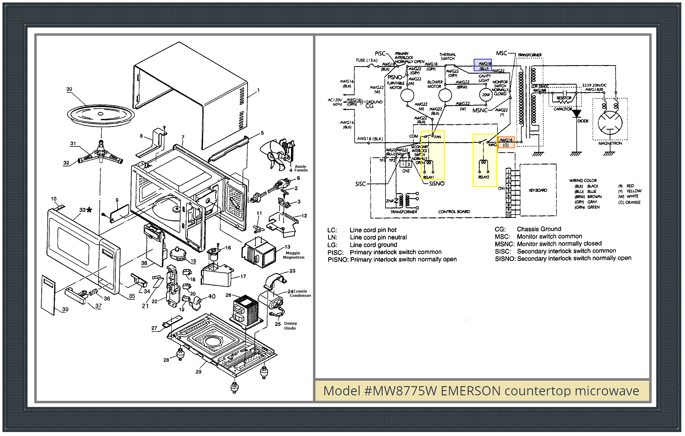

This microwave oven didn't come with any schematic. What I've found is this:
---> 0.8 ohms between primary of power xformer;
---> infinity resistance between primary & Gnd;
---> a cable between primary electrode & Magnetron shows infinity to Gnd;
---> another electrode from this xformer to the capacitor shows infinity to Gnd;
---> between the capacitor's electrode it shows a downward count starting at ~30 Mohms & reaching ~10 Mohms in about 30 secs (both polarities);
---> capacitor electrodes to Gnd shows infinity resistance;
---> diode electrodes = infinity (both polarities);
---> magnetron electrodes = 0.3 ohms;
---> magnetron's electrodes to Gnd ~ infinity.
What I beleive is that there's a problem at the control panel that involves the "Powering Relay" but haven't conduct any test around this hipothesis preferring to wait for the schematic.
Any ideas instead?

This's a rather unusual wiring for this application compared to at least 8 other microwave ovens I've seen. See attachement below.
No visible label for the xformer! Do you think it's a good idea to take it out & check if there's one at the other side or below and then trying to find what measurement reading I should have at the primary?
Edit: Have taken out the xformer & it has no label nor printed info on any side???

Since you blew the fuse, that confirms that you are getting solid AC line voltage power to the marked ORANGE and BLUE square terminal markups at the primary of the power transformer.
Why not now totally pull the substitute maggie and unscrew and lift the cathode of the HV rectifier diode high enough so that it can't possibly arc to case ground.
Then re- fuse and power up only for ONLY 3 seconds or so to confirm that you are now not blowing the fuse again.
