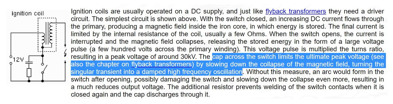

I got a question about flybacks. We all know the principle of the flyback, exactly the same principle used in bucking converters and ignition coils, feed, break, collapse, repeat.. the thing is i'd like to convey max power from the supply and i don't like the fact that power is conveyed only half of the time. So i would like flyback without internal diodes, to use the AC output (and full wave rectify it), but ferrite transformers for sale are either too small or too big. I know i could tear FB apart and take the diodes out but that gets messy and winding can get damaged. I asked them on alibaba if they could sell just the core and secondary winding, we'll see.
I know i can also use bigger PS and two flybacks in parallel in normal flyback mode (with internal diode) to convey the same power, that sure is an option.
But the real question is if using it as normal transformer (pulsed DC or AC input and AC output) vs flyback mode (pulsed DC input, pulsed DC output) conveys more energy at all.
Consider first the normal transformer behaviour. Take 220V tranformer, it can be plugged into the wall 24/7, primary is a short circuit, yet it dissipates very little energy, of course this is due to inductance of the primary making the V-I 90° out of phase. Once load is put on the secondary to the power source driving the primary it appears as if the core suddenly got more lossy and this brings V-I more or less in phase, making the circuit resistive, dissipating energy.
Now for flyback, current is fed into the primary and is then cut off, but if it's let to flow even slightest bit beyond what's needed to establish max current, that is already an energy waste, so frequency/duty cycle must be optimal. Then, as source is cut off, field collapses and this induces a voltage spike in the secondary. This voltage takes a shape of a falling ramp, more less a sawtooth. Great article about this Avian’s Blog: On the output voltage of a real flyback converter (tablix.org)
This field collapse sure is not constant, constant change of flux would produce a square, not a sawtooth. Clearly, flux first falls off quickly and then tapers off. But this is beside the point, just my little observation.
And so the energy that was stored in the primary core is transferred to the secondary.
But still question is, if we use it as normal transformer with secondary conducting during both halfcycles, current will surely not rise to same height in the primary as it would were the secondary open during the first halfcycle. Overall, it is not impossible that flyback stores more energy in the core during first halfcyle while secondary is open, then it does for both halfcycles combined in normal transformer operation mode.
But i am not sure, i am speculating and i want to know to chose which way to go with this, goal is like i said, to convery max power, hopefully avoiding doubling power supply and flybacks. So question is, what gives more power, flyback operated in flyback mode with half rectified output or normal transformer mode with full rectified output.
I would go with the latter with about 90% certainty but would like your opinion.

A normal AC transformer uses the magnetic core to transfer the energy from primary to secondary with the turns-ratio determining the primary voltage to the secondary voltage..
It never stores any significant energy as the inductance is just to determine the value of the small magnetizing current.
A flyback stores significant energy in the transformer inductance when the primary conducts current, and transfers that energy to the secondary when the primary is open-circuited.
The secondary voltage step-up is determined by the primary peak voltage when the primary is open-circuited times the turns ratio.
This primary peak voltage can be much higher the the primary applied voltage.
The transformer is basically a multi-winding inductor.
So the two modes of operation are entirely different and can't be readily compared as you are attempting.
That makes little sense to me.
You cant have a flyback without a diode to rectify the output.
There is no full-wave output from a flyback.

Talking of ignition coil, the reason for cap across the switch (be it mechanical relay or a MOSFET) is to limit the peak voltage, cap appearing as a short for an instant and lower the resistance in the circuit of the collapsing flux, lower will be the peak, obviously, higher the resistance higher the peak and faster will it burn out.
