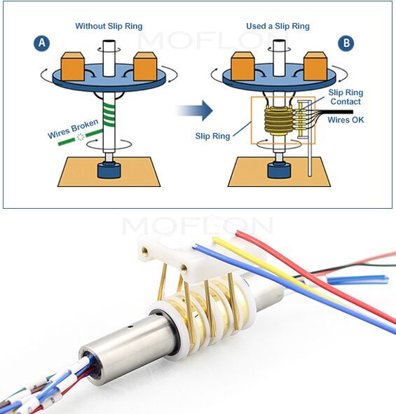

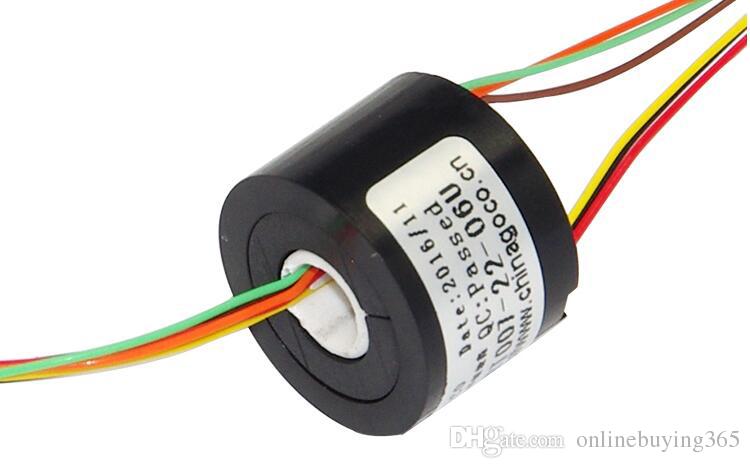

If you want to have the display rotate, the use of a slip ring is required.
As for the small trucks being towed or on the flat beds, they would also be wired in the same way as the larger trucks. Or simply added to the larger trucks connections.
If the display case is very large, you could put each truck on it's own slip ring. That would look rather nice.

Thanks Martin, the photos help me visualize what you are talking about. At the moment there are twenty items for display plus 1-2 minis per truck. I just realized rotation will take up a lot of room so I think I will have to scale back to a linear cubby style display case. Thanks for you advice. If you ever need carpentry advice please ask, it’s al I know......so far. :)
