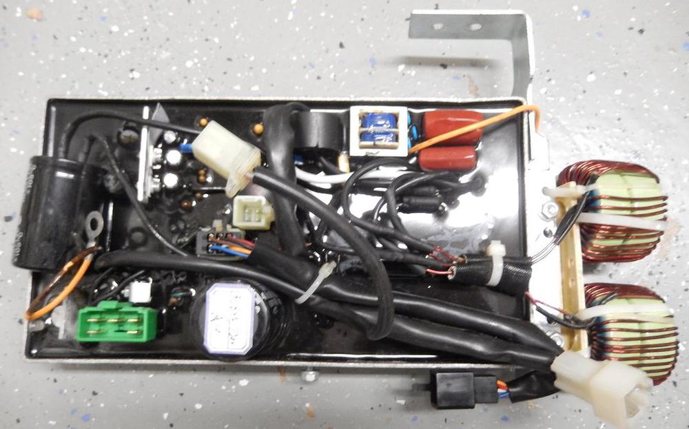

I have a Powerhouse PH3100Ri generator with no A/C output at receptacle. The stator output voltage is 300v on all legs. When I plug the stator into the inverter the engine will not run. It will start at very low rpm and then die. The D/C output is fine when the stator is unplugged from the inverter.
Ideas? Suggestions?
Thanks,
Daryl

Sounds like a short circuit on the input of the inverter. If the component parts are accessible (more often they are embedded in epoxy so almost impossible to service) then check the main rectifier(s).

Thanks for the reply. I checked the input terminals on the inverter and I see no resistance between terminals or to inverter case.
You may need a low ohm tester as a multimeter will not show that low a value.
Then you may need to disassemble and test the windings with a growler.

Garantee the Inverter block is faulty Same thing hapened to one of my inverter generators. I eventualy found a generator in the scrap yard with a engine that threw con rod. Used its inverter to get mine going again.

Exactly what I was afraid of! Let the parts hunting begin:(. Thanks

Can you post a picture of the inverter module?
As with many switched-mode type circuits, capacitor faults are high on the 'problem' list and since some of them stick out above the epoxy filling you can (1) spot the faulty capacitor (bulging/cracked top) and (2) 'dig' them out and replace them as you can get access to the leads through the body of the capacitor itself.

The small capacitors look OK. One of the large ones seems to have a bulged end.
I am a new user. How do I attach pictures?

Certainly might look that way.
More definitively . . . . . .has it split right at the very center of that stamp distressed metal triad apex ? , and can you get a very small gauge pin / needle down into the crack ?
If so, you have lost sealing, along with electrolyte and a resultant dry out and severe drop in effective overall capacitance . . . . possibly, it now only being mere micro farads.
No potting visible . . . as far as i can see downwards in your photo . . . . possibly its only having a THICK conformal coating on the board . . .Ug g g g g g gh !
Go get em, tiger !
OOPSIES ! . . . . . .looks like it is being potted city . . . .
I see at least 5 E-caps and possibly two more to the side of the laid on its side unit.

No actual break in the end of the capacitor. Your picture is the exact unit that I have.

Sadly the pics don't help - I thought it might be possible to see something I recognised as a potential problem however the iniquitous black 'gunk' has always thwarted such efforts.
Looks like you're going to be seeking a replacement part.
