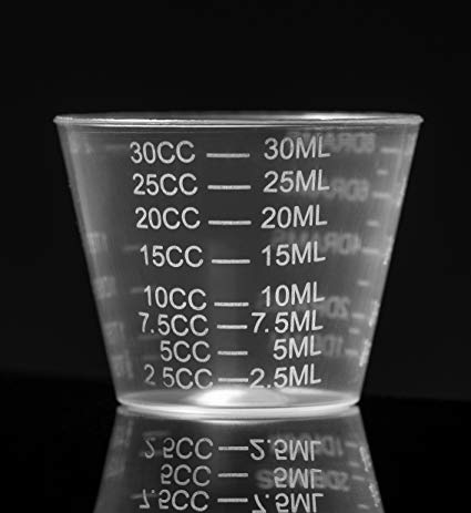

Clear plastic medicine/pill cups, with the markings on the side. Example:
https://www.amazon.com/HomEquip-Graduated-Medicine-Non-Sterile-Disposable/dp/B01MZ64XGJ
https://www.amazon.com/Dynarex-4252-1-Medicine-Polyethylene-Count/dp/B01N6MXK13
Similar cups come in larger sizes too but often don't have the markings on them. In that case measure half the quantity in water, pour it in and use a marker to draw a line at that level, then add that much water again and draw a second line.
However, and this is more of an issue with faster setting epoxy, it is exothermic as it sets so having it in a small surface area vessel will make it cure faster than if it were spread out more.

I'll have to try this since using the 2-cup method the donor cup always retains some residue and I end up with an unequal mixture. I think that and 2 syringes should do it.
