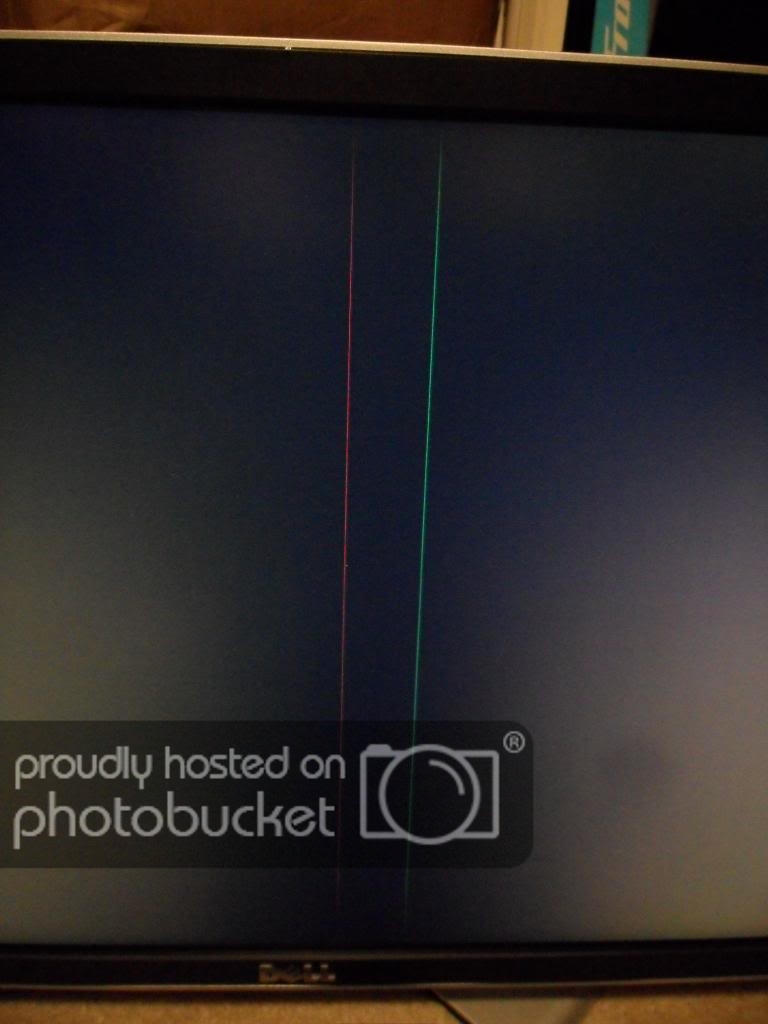

I have 5 monitors that needs repair these are either the DELL 3007WFP or 3008WFP, I have attached some pictures

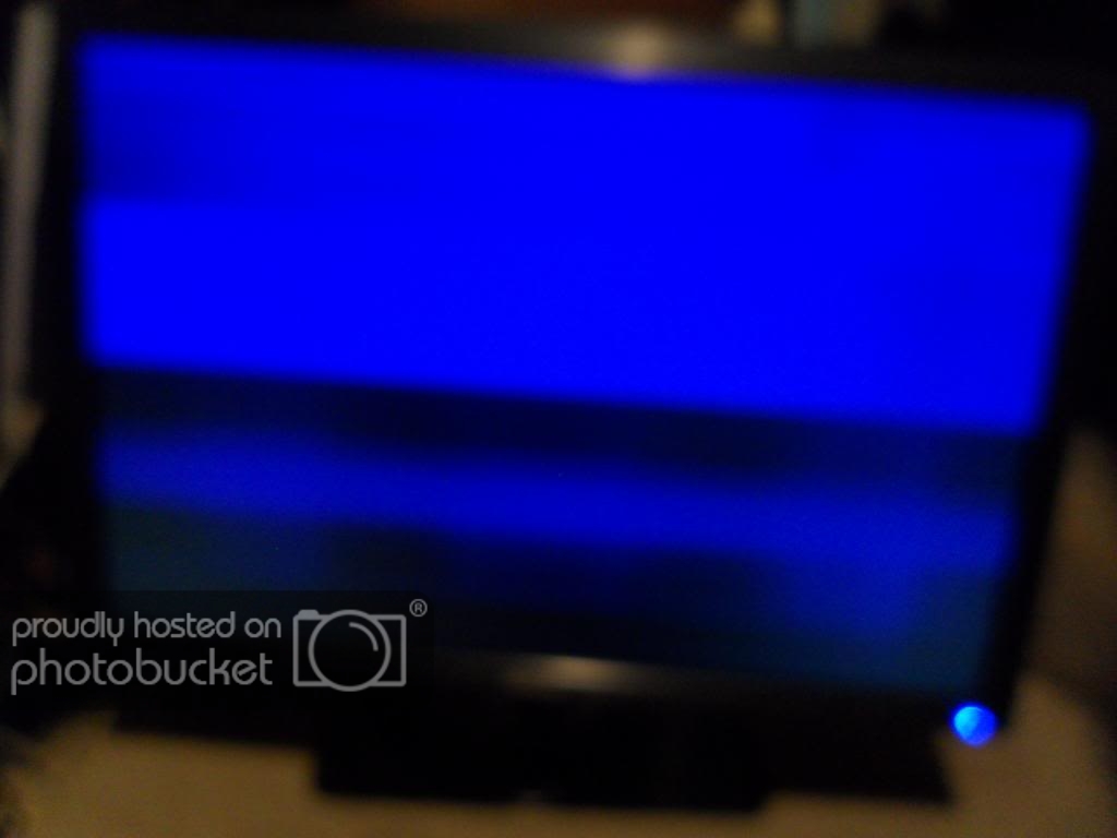

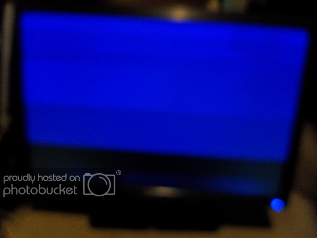

Monitor A - When plugged into a computer, it shows nothing but a blue screen with random flashing scan lines of black, the black lines just disappears and comes back in a very fast continuously motion.

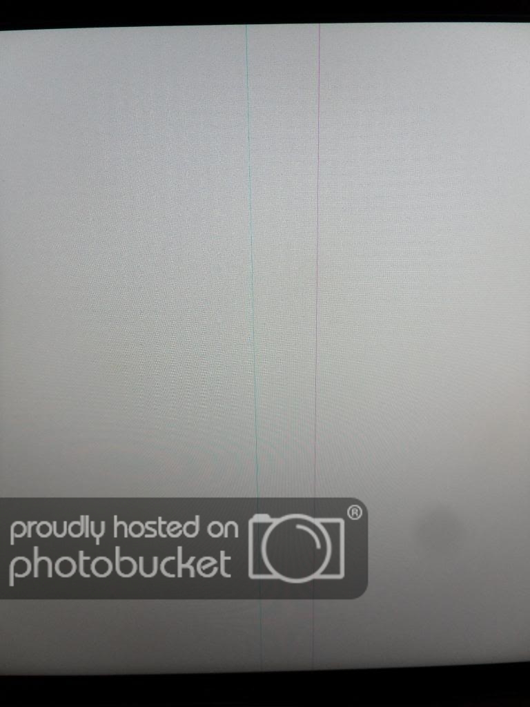

Monitor B - It has 2 discolored lines running from top to bottom of monitor

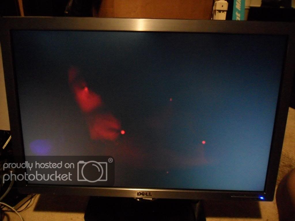

Monitor C - It shows large blur spots and dots of red and blue but only shows on BLACK background every other color backgrounds it is not as obvious.

Faults with vertical or horizontal lines (that don't move) generally indicate a problem with the row or column drivers or connections.
For the random flashing type of fault, you could do worst than look at the power supply first just in case it's gone absolutely berserk. In most monitors this type of fault normally prevents the monitor from powering up at all though.

The ones with horizontal lines, what part would I need to replace? how much will it cost to fix this???
with all the other monitors, based on the problem symptoms, can you actually tell which part is having problems??? So I know which part to order and replace?? thank you

You would need to know the make and model of each, and probably even then you'll find various revisions which are all different.
Do you know what's in an LCD monitor?
1) screen (with integral driver)
2) interface/logic board
3) backlight inverter/controller
4) power supply
3 and 4 are often repairable, but none of the faults are suggestive of this.
2 is maybe replaceable, but might cost more than a new monitor. Something very obvious might be repairable.
1 is almost certainly going to cost more than a new monitor.
If you have several units, all the same make, model, and revision, you may be able to make a good monitor from what you have.
