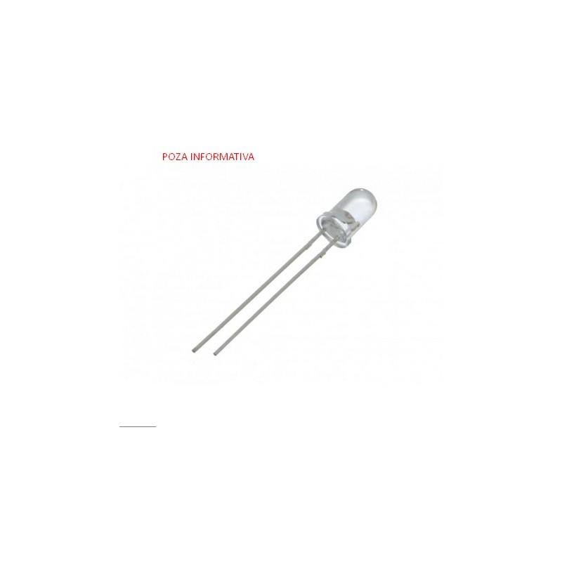

I will use a simple LED. I have a bunch of theese:
The maximum forward voltage is 2V. How many ohms should the resistor have to drop from 12V to 2V?
