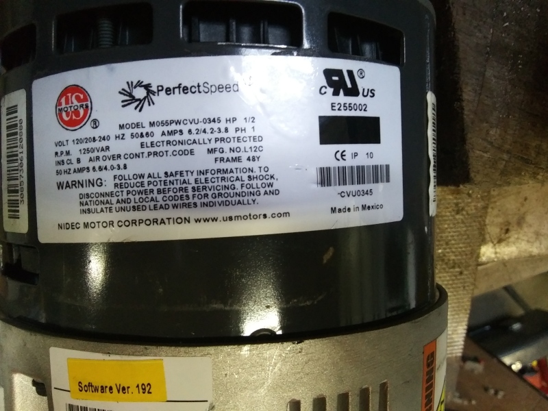

having a hard time uploading photos from my phone -
that nameplate is on the motor, there is a second nameplate on the bottom part of the motor where the control wires go.
US MOTORS PerfectSpeed
EEPROM DATA E077906820000
PART NUMBER X177906810001
IN 120/208-240 VAC 1 PH 6.6/4.0-4.8 & 6.2/4.2-3.8 AMPS
US PATS xxx xxx xxx FOR USE WITH AA251702
xxx xxx xxx xxx xxx FOR USE WITH 1/2HP MOTOR
xxx xxx xxx xxx xxx MO55PWCVU-0345
NIDEC MOTOR CORPORATION www.usmotors.com
