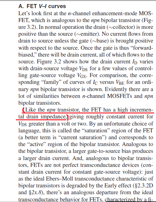

Hello guys, I don't understand the meaning of this line
"The FET has a high incremental drain impedance, giving roughly constant current for VDS greater than a volt or two"
from field-effect transistors chapter of the book "The art of electronics".
Here what does it means by "high incremental drain impedance" Can anyone help me to understand it?

resistance: [imath]R = \frac {V}{I}[/imath] -> absolute values are used
incremental or differential resistance: [imath]R_{inc} = \frac{dV} {dI}[/imath] -> differential values are used
For a "normal" resistor [imath]R = R_{inc}[/imath].
For a nonlinear component [imath]R \neq R_{inc}[/imath].
The references given in the other answers give more detailed explanation.
