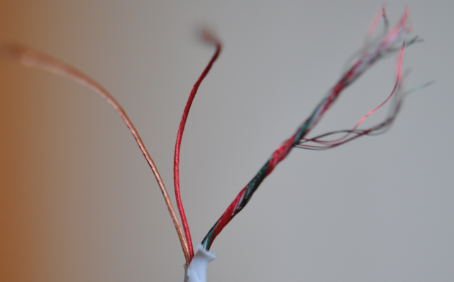

I opened an earphone case to fix a cable that was losing connection, and I noticed one of the two cables is a blue that doesn't seem to have any visible copper in it, it does not short-circuit if the two wires touch each other, but after I cut the colored opened it does not appear to have any copper in it, so I wonder how does it connect to the end?

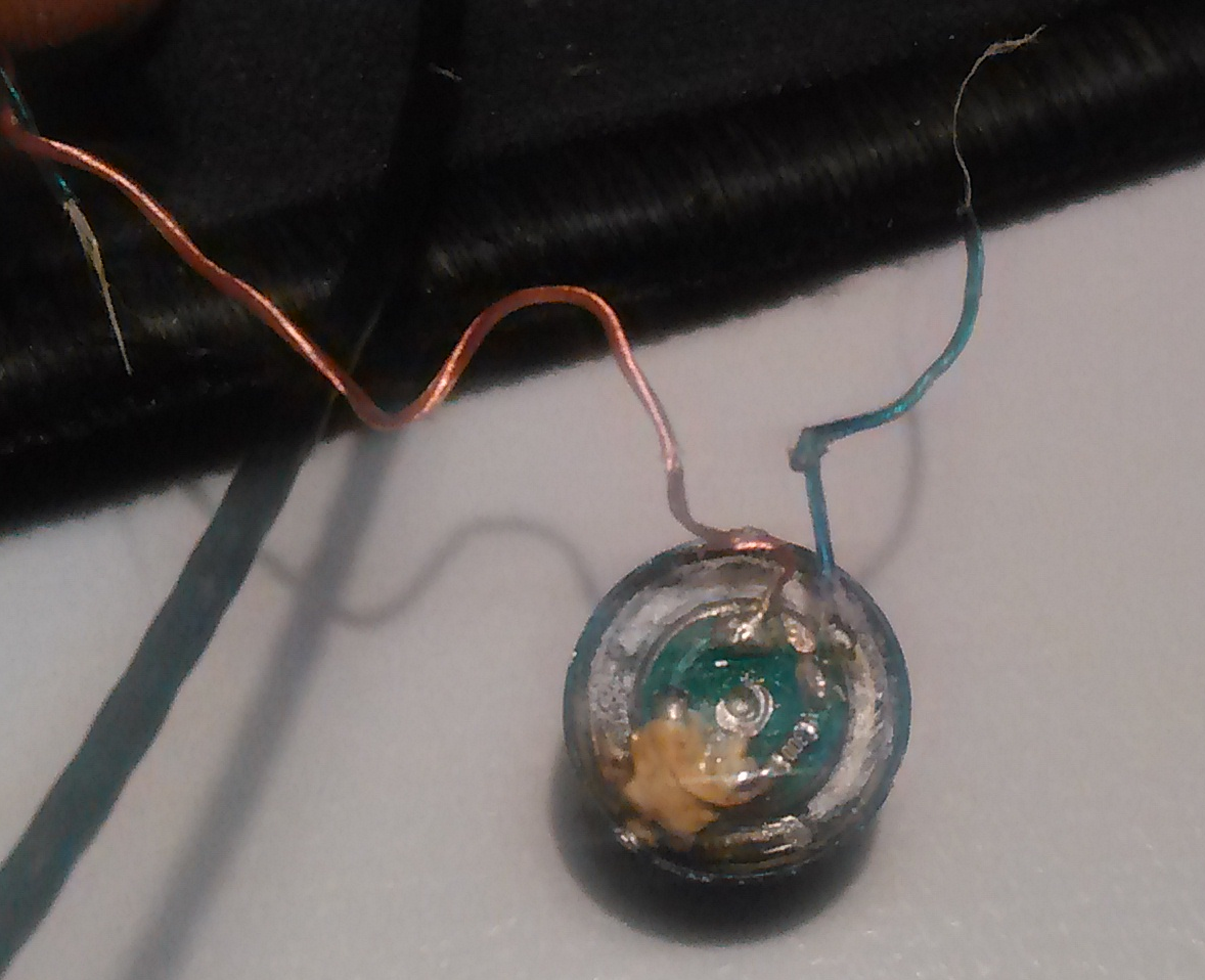

That wasn't easy to solder at all. It's as if the copper-colored one can easily conduct but the blue one conducts only with the solder.

Looks like all is well with the COPPER colored stranded wire, but the BLUE stranded wire looks to have broken and pulled up within its secondary, clear colored insulative shell.
That leaves a pulled up BLUE stranded wire set within the clear insulative shell.
I would say that if you might go up from the blue end about an 1/8---1/4 of an inch and cut away the clear coating, so that you would then be able to see the blue wires end.
You then heat up a solder blob and place the blue wire end in that blob while continuing heating the blob,then add some fresh solder, I then certainly think that BLUE wire is having Soldereze insulation, so that it both pulls back up the wire and melts and you should soon see a tinned wire end.
Then, solder the BLUE wire back to its break away point.

That's not the issue. Those cables have a particular technology that does not contact at all, or almost at all, unless it's soldered. It's as if they are designed to be both (not just the gold-looking one) in contact with each other and then directly soldered.
I wonder what that tech is.

any enamelled wire if commonly referred to as magnet wire ... it's nothing special and isn't magnetic
Line thin strains with insulation weaved together.
thin wires and thin strands of nylon intertwined make very flexible cables, purpose made for headphones, microphone headsets etc
the enamel coating on the wire is the insulation

2 cents, the Chinese masters of cheap have decided that most cheap ear buds headset have 2 strands of wire in a sheath both coated with some insulating film, colour denoting polarity. I just take a knife and scrape the coating then solder, but use real solder, (not the new environmentally friendly stuff)
