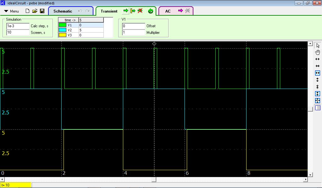

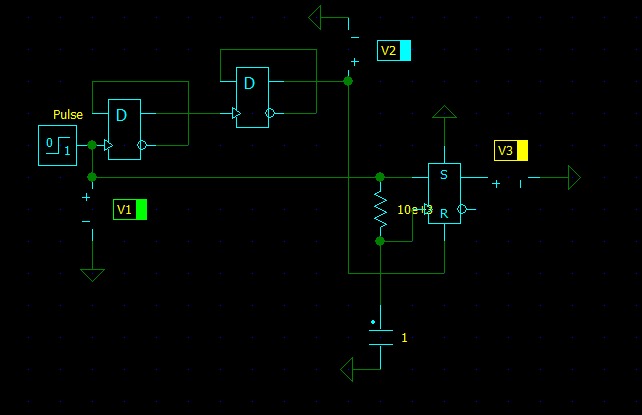

Here's a simpler solution that was suggested to me.
Here's my version of the same circuit. (note, the D's are not part of the solution, they are use to generate C2):
It seems like a great idea. I prefer it's single-component simplicity to your solution (no offense).
But as you can see from the trace (below), the output is not going high and low as desired. I need Q to go high on the first C1 rise after the first C2 rise, as described in the OP.
another issue with this solution is, i'm seeing rises in the output on C1 falls, which is not desired. All changes should happen only on rising edges....
I'd like to go with the simpler solution if possible. Any ideas?
thank you!

I think you need to rethink your requirements. Your definition of the behaviour you want is not clear. Your first post says "When C1 goes high" and "When C2 goes high" which to me implies edge-triggered behaviour. The 4013-based suggestion will give you edge-triggered behaviour (with a short delay) for C1, but not C2. The output will be HELD low WHILE C2 is high. Is that what you want?
Your schematic is interesting. Your C2 clock is derived from your C1 clock using two cascaded T flip-flops, i.e. a divide-by-4 circuit. Is this just for testing, or is it your final design? If the two clocks are synchronous, there will be a much easier way to design the circuit.
I had assumed the clocks were asynchronous, which was why you needed the edge-triggered behaviour. If that's not the case, your output can be defined in terms of a single clock input. Can you write up this definition? It should become clear that the logic you need is quite simple. Just describe the behaviour you want to see at "V3" (the output) in terms of the transitions at "V1" (the input).
