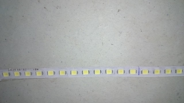

how can i determine the right voltage that could light up some leds in old lamp because it's own adapter is missing
is it related to the number of the leds in it or what
it's a rounded lamp and the leds like a string around it
when i test it on the diode mode with my multimeter i find out that each 4 leds light up together as they are connected in parallel ..so to light the whole string how much voltage do i need

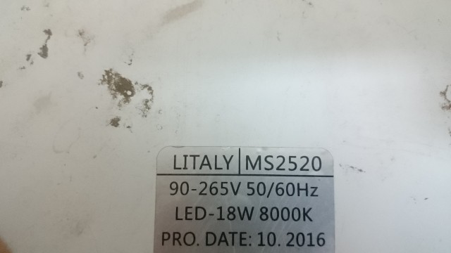

Has the lamp got a label on it with any information?
The connecter where the adapter goes, has that got any information on?.
and i count it's all 90 leds

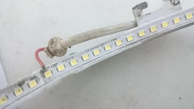

From the label, it looks to me like whatever that LED strip came out of already has a mains driven unit inside it.
Not a monitor by any chance..??

The question i submitted was to find where the LED strip originated as it might give some insight as to the control required.
Your photo suggests it came from some piece of equipment.

it's a lamp and there's no other data available , only 18 watt on the back of the lamp
so based on the number and the watt can't i determine the required voltage to lighten it up

Assuming all the LEDs are the same, then 18W/90 = 0.2W per LED. If we now assume the LED Vf is 3V, then the implied current per LED is 200mW/3V = ~66mA. So a group of 4 LEDs in parallel would draw 264mA max. There could be 90/4 = 22 such groups wired in series (can you check?).
The wide input voltage range of the lamp indicates the power supply was a SwitchMode type. My guess is that it was configured as a 250mA constant-current supply, with an output voltage rating of just over 3V x 22 = 66V.

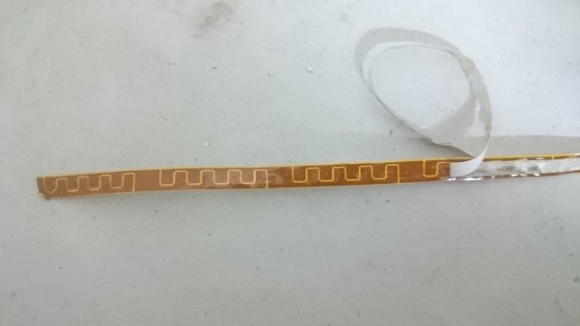

they all share the positive line but the negative is every 5 leds
o_O That rules out a series connection of groups each having 5-in-parallel. The only reason for wiring them that way, that I can think of, is if the groups are multiplexed, or selectively switched. Seems unlikely.
Edit: It's hard to tell from the post #10 picture, but it looks like the 5 LEDs of a group could be in series, with the 18 groups in parallel across the +ve and -ve rails. If that were the case, then the power supply would be something like 5 x 3V = 15V with a current rating of 18 x 60mA = 1.08A, which seems plausible and probably obtainable.
Are you absolutely certain the 5 LEDs of a group are electrically in parallel?

There do not appear to be any resistors on the strip, which means, whatever configuration they are using, it is not likely designed for a constant voltage supply. I am going to take a wild guess and say they have paralleled 5 strips of 18, which would make the voltage somewhere in the range of 50-60V and driven it with a constant current driver at around 300mA. That sounds about right as it would have about 60mA on each LED, and those look like medium power LEDs like that.
If you can determine the actual connection scheme and verify that there are no resistors, or tell us if there are, it would help.

Bob, I have a funny feeling the Op is using a different LED strip in the 2 photos supplied.
Bottom photo is what appears to be the protective paper stripped back from the "sticky surface" and I assume it to be a new strip.
Whereas the top photo is all gunky and grimy like it's been around for a while in the garden.

Now that I look at the back side of the strip, it looks like 5 in series.
That wold argue for a lower vottage of 15 or 16V.

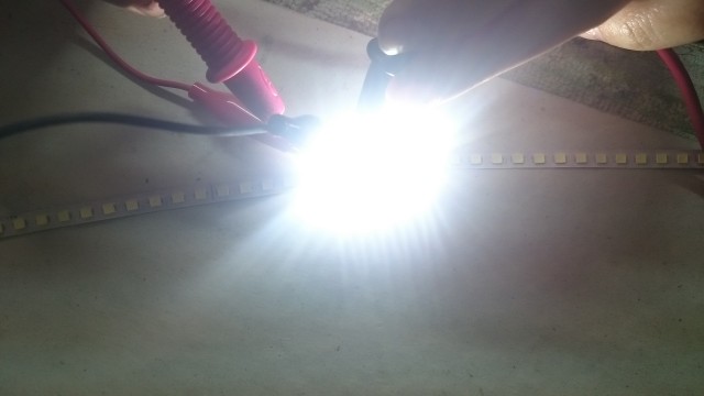

here, this pic for me using 3.5 v with 0.2 ampere on one led and you can see the 5 is light up together

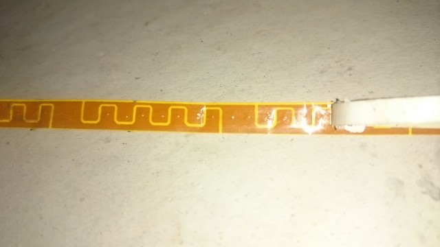

also i made some other picture for the led stripe
the little dots shows where the led is connected from the other side
ahhh....no we can't. Did you even look at the photo you took.
It is just a bright overwhelming flash where zero detail is visible.
Blowed if I can see any "white dots" except for the previous flash that made my eyes kinda wonky. :eek:o_O

I don't see how you can light up just 5 of the LEDs on that strip. It looks like there are conductors top and bottom, which would be power and ground, and then 5 LEDs in series between them. If you power any of it, it should be powering all of it.
In any case, it cannot be driven by a voltage source since there appears to be no current limiting (normally resistors) on the strip.
