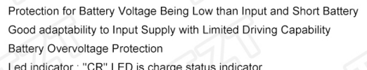

As for charging, I found this module on AliExpress but I'm not sure if it's only for charging or does it also have overcharge limiting capabilities.
The website states:
