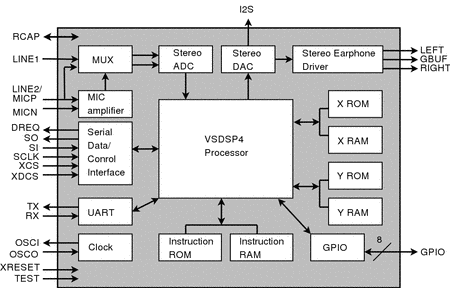

hi
is there any IC Or code for Controlers to convert sounds to MP3 or MDI Streem Output?
how could record mp3 format by XMega?
which IC can Do this?
vs1003 can play mp3 but can not make mp3 output. it only make wave format for out put.
any one can help me please!?

The VS1063 is also an MP3 Encoder. It works fine for real time compression into MP3 format, along with several other formats. I recommend acquiring the evaluation board for the chip then start experimenting.
"The VS1063 IC can encode an unforeseen multitude of audio formats, from MP3 and Ogg Vorbis to G.711 u-law, G.711 A-law, G.722 and 16-bit PCM. The proprietary MP3 encoder and Ogg Vorbis encoder have been carefully tuned for highest possible audio fidelity for high-quality audio streaming or recording."
