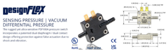

My apologies if I didn't post this in the right thread.
I have a pressure switch, and want to use it to turn on/off a 110V extension cord. I feel like an idiot for asking because it seems like such a simple task, but so far every answer I've seen is too technical for me to understand.
I can blow into the pressure switch and verify that the switch is closing, and I have a 110v source. It seems like a relay would do the trick, but everything I've seen implies that it takes a low voltage source to trigger the relay, and I'm hoping to avoid that.
A quick check on a spec sheet (which you should have supplied to save us the trouble of looking for it) shows they are indeed a low voltage low current sensor.
In that instance, a relay operating from low voltage would be required.
You also say "110v extension lead" as a load...........you also need to know the load current to select the correct relay for the job.
Manufacturer suggests solid state relay.
Mostly they will recommend these as coil induction effect of standard relay/contactors can have effect on the sensor.
Too bad. The switch is rated for a max. of 30 V, so you will need a low voltage supply. Simple and cheap - an old USB wall wart / phone charger / camera charger / etc. That, plus a solid state relay rated for at least 50% more than your 110 V load current. Most SSR's have a current-limiting input so you do not need an external resistor.
DC output wall wart >> switch >> SSR.
