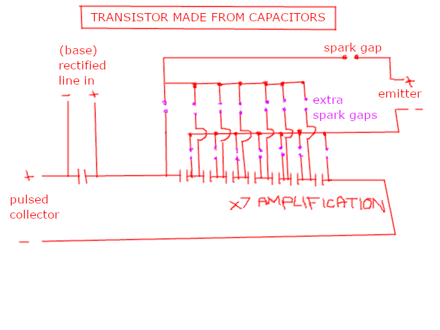

heres a schematic of it.
the extra spark gaps can be diodes if you want, they are to stop the capacitors prematurely discharging, but it sorta spoils it adding pn junctions.
As you can see its the reverse of a marx generator, charge series, discharge parallel.
[edit] i think the circuit is a bit wrong, it needs to be fixed. but the general idea is there. [/edit]

What you show is not amplification as we usually designate it. We're back to your not using the terms of the trade as (almost) everyone else does. Or using the terms in a non-conventional (to use a benign expression) way. Thus you create misunderstanding at the least.
Amplification in the sense usually used is the effect of inputting a small signal and outputting a signal at the same waveform but with a higher amplitude (e.g. higher voltage, higher current, or both). Think of an audio amplifier.
I am not going to analyze your circuit in detail, but if you were to input a sine wave at the "base", you're not going to get a sine wave with higher amplitude (voltage) at your so called "emitter". The Fidelity of the input signal will by no means be preserved.
This circuit will not work as a transistor.

Yes you are correct, it works best with binary signals, but I bet if you teamed up 8 of them with an adc going into them, you could bring back an analogue signal composed of so many binary amplifications. But it definitely responds off with off, and on with on, but maybe halfway between wont work so well, and the system runs off a spark gap, its not continuous, it needs to be oscillated at the nyquist.

Say I have 3 capacitors in series, but the 1st capacitor is either charged or uncharged before hand, the other 2 capacitors are empty. (Thats the thing everyone always misses.)
If the 1st capacitor is charged, no current can go though, and the 2 other capacitors remain empty, but if it isn't, all 3 caps will charge, the 2 capacitors will charge from the single capacitor being what decides them to charge.
Then you have 2 capacitors charged from 1 capacitor, an increase in power. :)
But note its not the capacitor thats charging the 2 other capacitors... its the battery.

"Power" is energy over time. You are not making energy, so you can use that energy at any rate you can manage, but net energy is just the same, unless you are getting more from somewhere.
Capacitors store charge, at some voltage. They store energy. You can put it in & take it out, but it does not increase.
If you put it in slowly then the power is low, energy = power by time.
If you take it out quickly, then yes, higher instantaneous power than you had putting it in, but the same energy. The resulting power * time (integrals for changing quantities) will be the same.
Maybe you understand this. Might just be the difference language usage others have mentioned.
