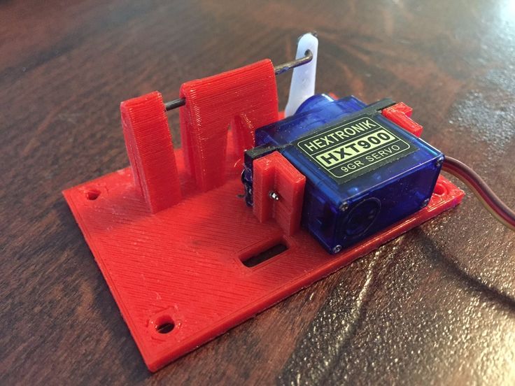

The way I see it is the exterior magnet mechanism should not release the string but move a trigger to release the string.
If there is a device/gadget re-purposable from something else, or toy ?? , please advise.

One thing not mentioned is how you will set the balloon string clamp in a sealed container. 20 Newtons to Pounds-force = 4.4962. That's a pretty hefty balloon. This is getting to be a "20-questions thread". Can you do a sketch of what you are trying the create?
Sometimes it's easier to help solve you problem, than help solve your solution. ;)
Now that we know you need a holding force of 20N. that makes sense. A reed switch inside the enclosure could acivate the servo shown in your pic.

Ken : The string is held outside the 'bottle' by a release mechanism, a magnetic actuator is inside the 'bottle'. If your question is about resetting, take it as no resetting. After release; it's done.
Alec : The white arm in the last picture could be pulled levered towards the 'bottle' wall by a sliding magnet inside the 'bottle' instead of by a servo as pictured.
There is maaany ways to think and that is only one.
The magnetic pull would be very weak when the arm is away from wall, so I don't see that working well. Better perhaps if the lever were held against the wall initially, by the maximum pull of a stationary magnet, and then pulled away by a spring when the magnet moved?
