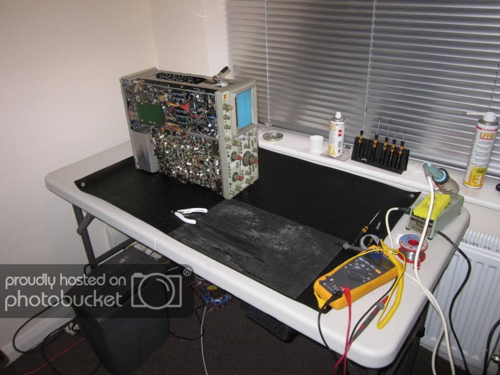

Thing is at the moment I'm working in cramped areas, moved house a year ago and it still looks as though I moved in last week :D
I need to invest in a plastic fold away table and antistatic mat to really take this thing apart.

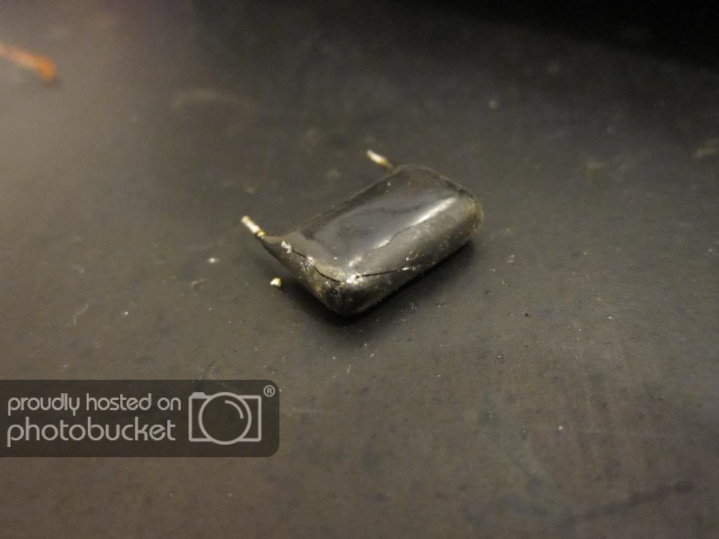

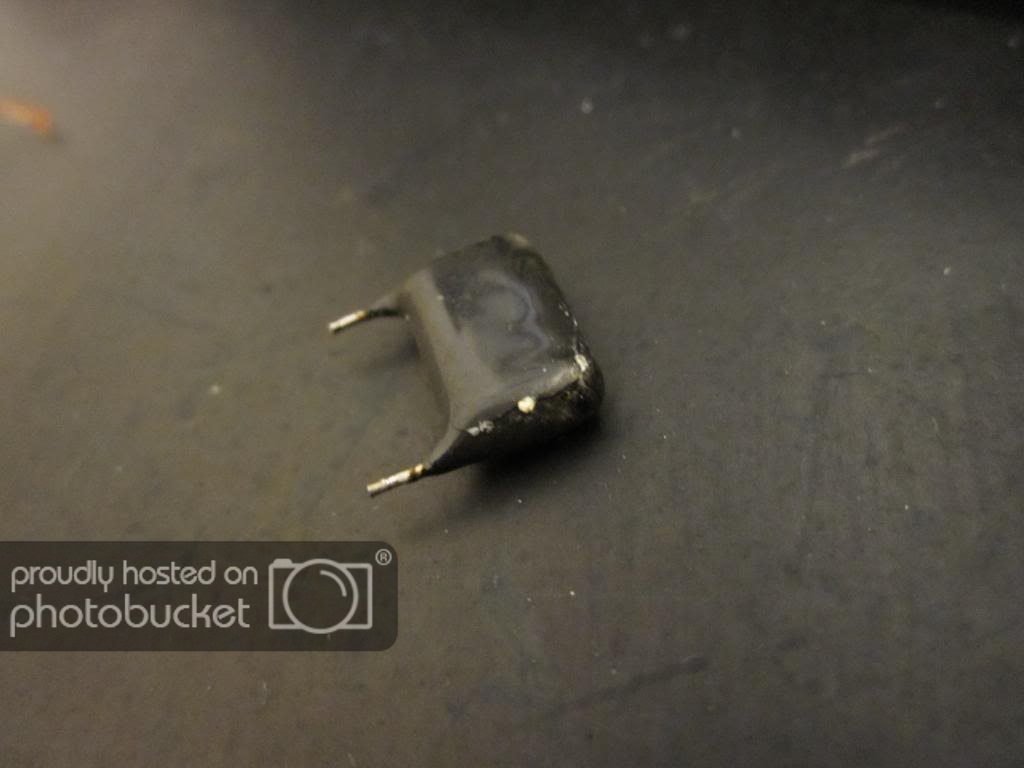

I've found a poly cap with a crack in it, otherwise, physically things appear ok, but I've no other way of testing the caps apart from my capacitance meter, which shows them as fine, but as we both know they may have developed a resistance.
I'll pop some photos up in a bit, I'll see if I can get a good photo of the cracked cap.

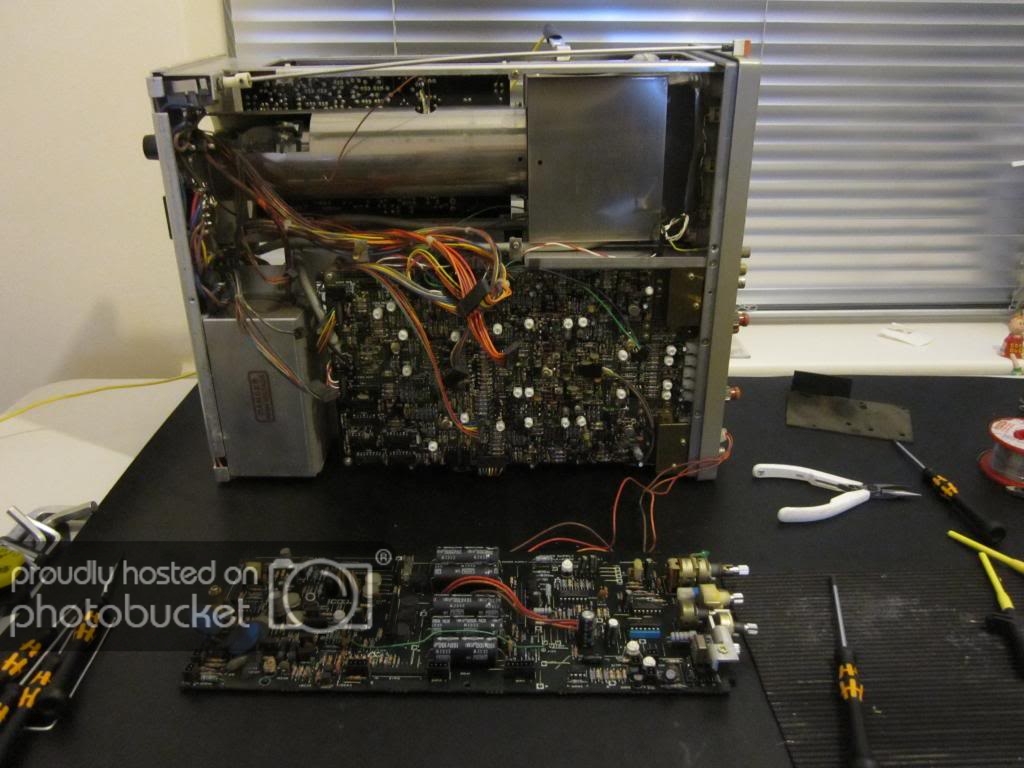

Here we are on the bench
Power supply board out
Cracked cap

Well, replace it. Where was it? Anywhere that might be connected with the problem?

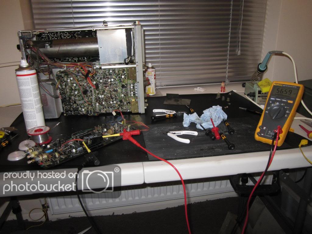

Ok, well have been doing what other tests I can to the caps until I get my hands on an ESR meter.
With my multimeter set to read capacitance, I'm getting between 4550 and 4800 mic farads for a 4700 mic farad electrolytic cap - so reads ok.
But on an LCR meter, at 120Hz, it's reading 03.61 milli farads - so maybe a bad cap found so far but without an ESR reading, until I can get an ESR meter?

At the very least, I'd compare the readings of your LCR meter with your capacitance function using a known good capacitor.
I presume both of these measurements have been taken out of circuit?
Do you have another scope? Here is a method of testing ESR. It's essentially what the ESR meters automate.

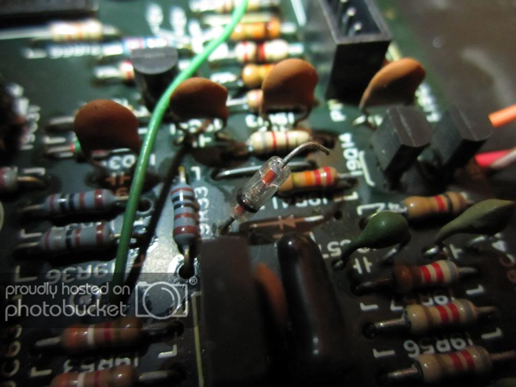

I've got a diode measuring (Fluke 179 on diode range) 2.4v one way and 0.26v the other way, so I assume that's shorted. I think it's a Schottky diode, manual says 1SS16, but I can't find one or cross reference one. There's no other specs in order for me to find one myself.
Any idea? Thanks.

That's the one, sticking up. Service manual only says its a 1SS16.

Do you have the schematic? What symbol does it show for this device? (normal diode, schottky diode, zener diode, etc...)
