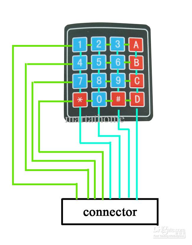

Dear all,
Hi to all,
My query is, recently i tried to interface 4x4 matrix keypad to the PIC16f877a controller and i found that my keypad buttons are getting automatically pressed whenever i make movement of keypad, to resolve and crosscheck this problem i have purchased a new keypad but still it is giving same problem. i hope the problem may be inside the keypad, but i don't know exactly what is the problem. If any one can suggest remedy to my problem i will be very thankful to him.

Circuit Diagram:
The connector shown above is directly connected to PORT of PIC controller without connecting rows or columns to Vcc supply via resistors. I have used same keypad as showed in figure above.
My program is: The code is for only first row of keypad remaining rows are also giving the same problem.

Bad design. First of all, pushing two buttons in the same column will short a low output to a high output.
But the problem you are seeing is because the input are floating when no button is pressed. You need a pullup resistor on each column. Then you need to change the row scanning to make only one row and output and put a zero on it, while the other rows are made to be inputs (I.e. by setting TRIS). Now when you push a button, you will see a zero on the column for that button when the row for that button is selected, and you will see a 1 in that column otherwise.

No, the problem is electrical and I told you how to solve it.
