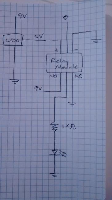

Hi everyone,
I have a question about the attached circuit:
(Sorry if it's unclear - I have very little experience in drawing circuit diagrams). What I have here is a 5V relay module powered by a battery, with an LDO providing the 5V input to the relay. When the signal (S) pin is low, the module and LED are off. When S is high, the module and LED are both on.
My question is this - when the module is on, after a while the LDO gets hot. Why is this? I figure I probably need to add another resistor somewhere, but where is the best place?

I think you need to limit the current into the relay so devide 5v by the required coil current to get resistor value and put it in series between ldo and relay coil. Also add a blocking diode parallel with coil to mitigate spikes.

The problem is likely that the current required to operate the relay is quite high and the power dissipation in the regulator is such that its getting hot.
I will assume that your reason for using a relay is more than just to turn on and off a LED, so I won't comment on that.
The first thing is to calibrate your finger so we have a good idea of how hot the regulator is actually getting. Look for this resource (sorry its hard to insert a link from a mobile platform) and let us know how hot it actually is.
if it is too hot then the options include using a relay with a lower operating current, using a physically larger regulator, attaching a heatsink to the regulator, or using a switch mode regulator (or even a combination of these).
of course the problem may also be that you have a writing error, but if the circuit operates then this is less likely.
The suggestion above to place a diode across the delay coil is one to be followed.

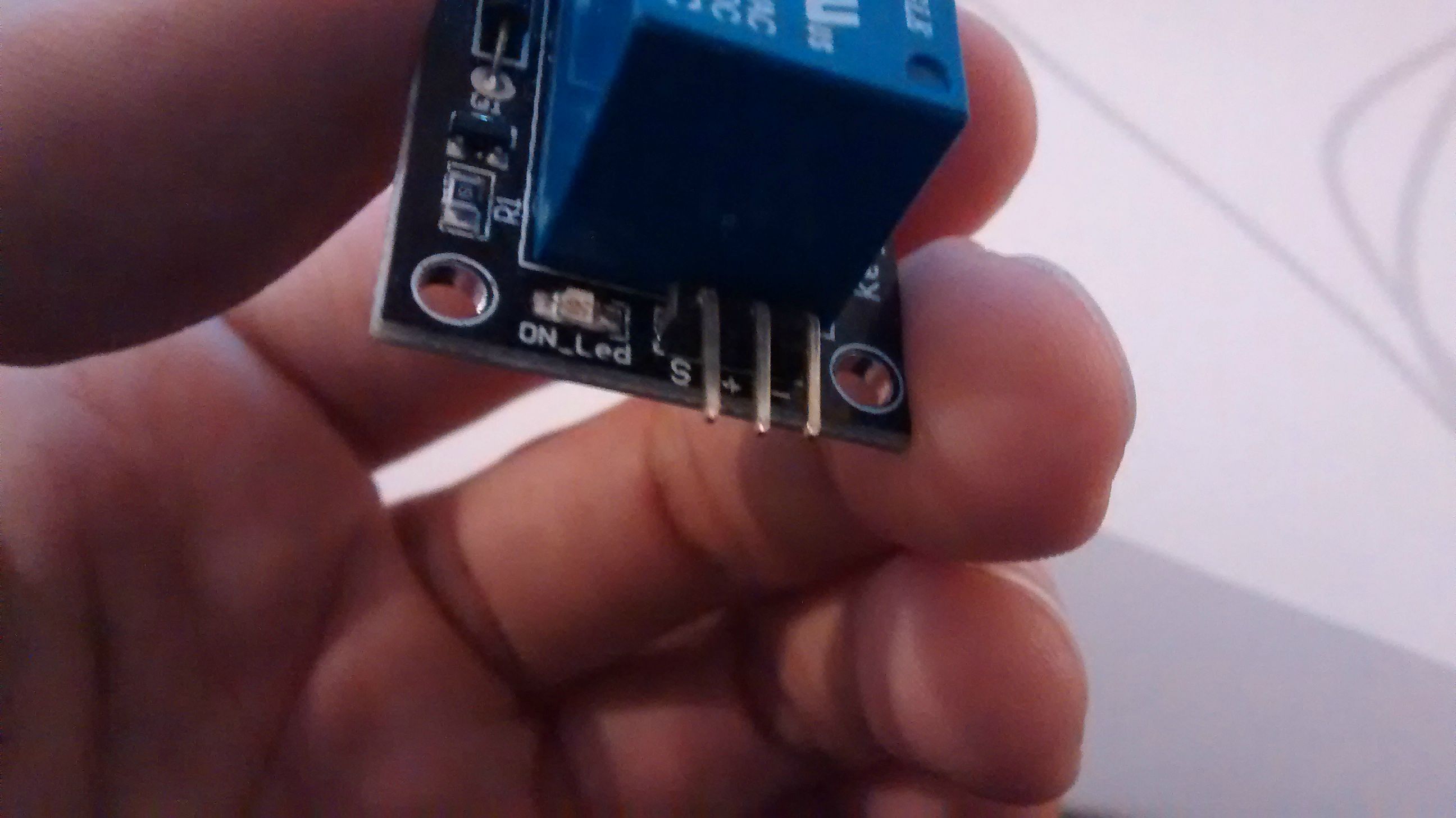

Could you please take a good photo of the relay both from the writing and the "legs" and post it here?

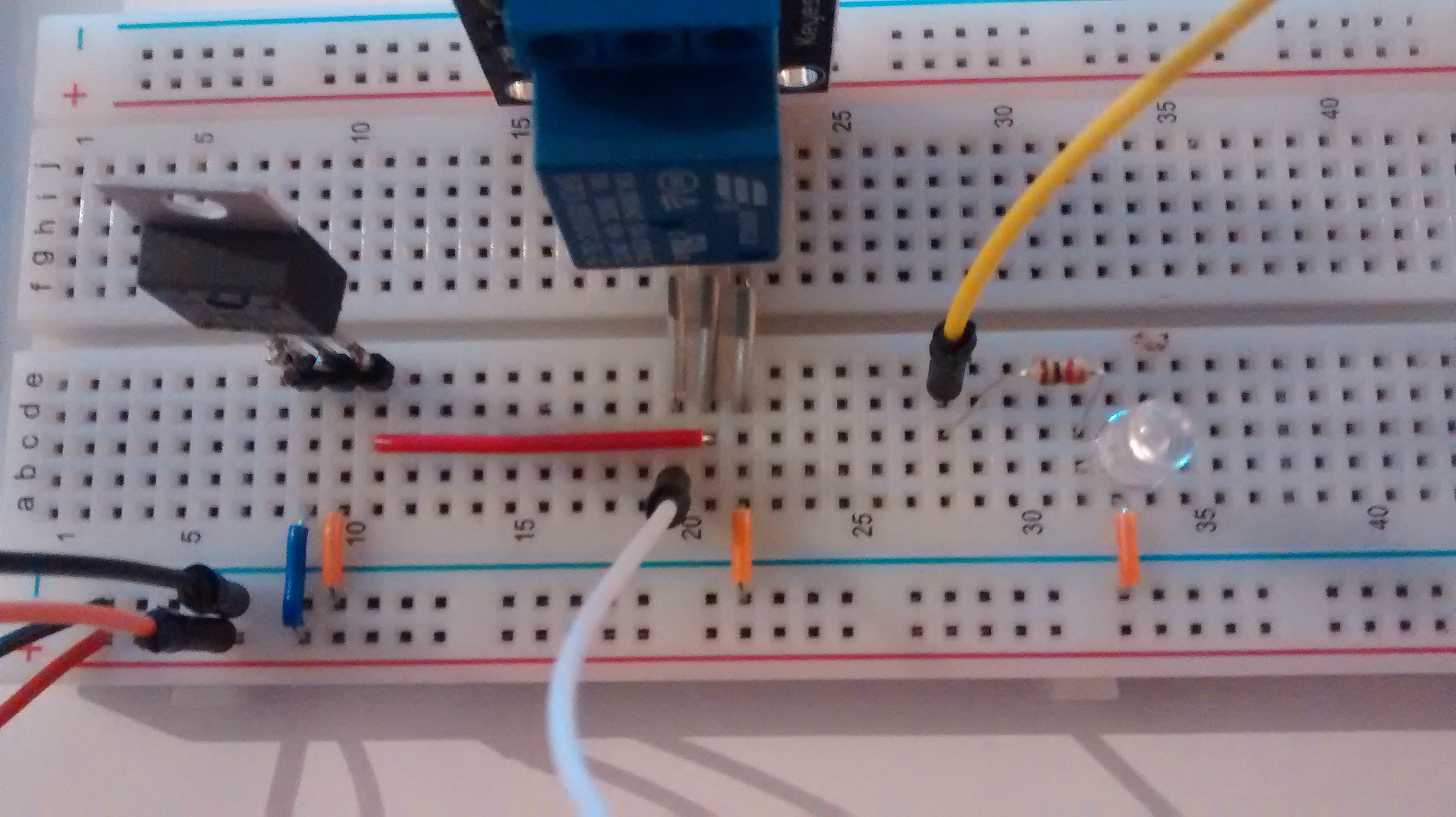

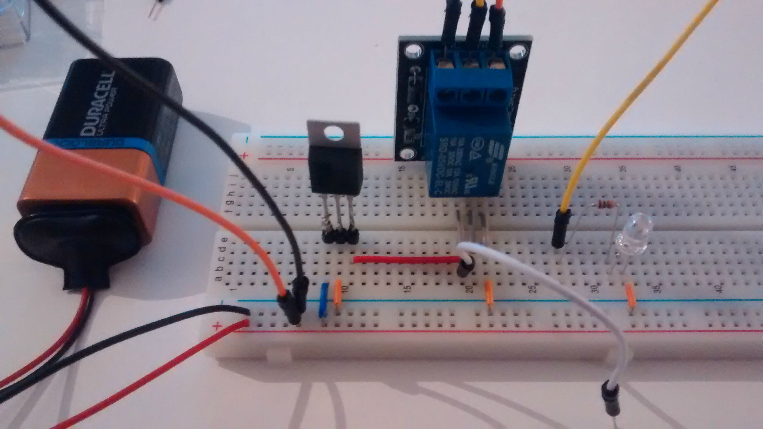

Sorry for the size of the following images. Here are shots of the circuit below, without a resistor between LDO and the relay. The LDO pins go from left to right: Vin, GND, Vout. The relay pins go: signal, +, -. The wires coming out the top of the relay are: NC, center, NO.

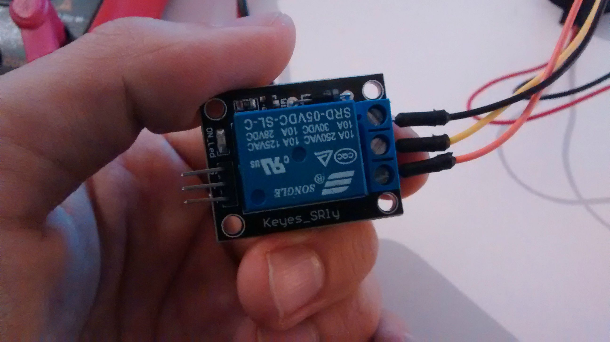

The relay itself looks like this:

The relay is srd-05vdc-sl-c from songle
As can be seen it's coil resistance(nominal) is 70 ohm and the coil current is71.4mA
Nominal voltage is 5V but it can be operated down to 75% pull-in that is 3.75V
The relay as 5 "legs", not 6 as your original drawing shows !
2 for the coil
3 for the the contacts,a very basic SPDT configuration
(1 common,1 normally closed and one normally open)
The power dissipation of the LDO driving the coil is thus about (9-5)*71.4mA=0.285W

ok, there's a lot to comment on...
firstly, the suggestion about the resistor requires that you place it in the right place and it has the correct value. I suggest that you skip using a resistor for the moment, but if you were to use one, there are two possible ways to use it. The first is in place of the regulator, the second is between the 9v source and the regulator. In both cases you need to know the likely range of input voltages, the current required, and (if you retain the reg) the dropout voltage of the regulator.
The next issue is the regulator you're using. You describe this as an LDO regulator and these are known to be unstable in certain cases. I note from the recent photos that you do not have any input or output capacitors connected to the reg. You need to connect a pair of 0.1uF caps one between the input and ground, and the other between output and ground.
The next issue has slipped my mind while waffling on about the previous ones. :)

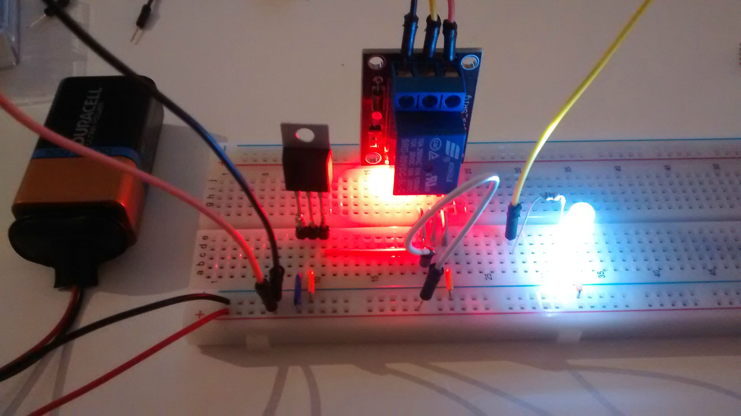

Recalculating the LDO power disipation
The max module current is about 85mA(from the data steve posted)
it agrees with the following:
71.4*1.1 (nominal coil current +10%) +3.5/1k(on borad red led)=82mA
Pd(LDO)=4*82mA=0.33W.
The funny thing is the board already has the LED to turn on...:rolleyes:
