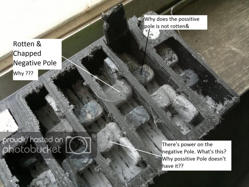

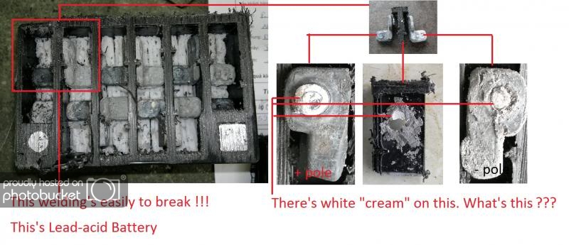

My Lead-acid battery went wrong, when open it, i found this. Please see the picture in those links and help me on this.
I am at [email protected]. Please notify me when you answer. Thank you so much.
Pic1:
Pic2:
Pic3:
Pic4:

The white gunge will be lead suphate, possibly formed if the battery has not been kept charged.
Lead and lead sulphate are poisonous as is sulphuric acid. Take the battery to a recycling centre where it can be disposed of safely.

Actually investigating this case is a part of my job. Would you please help me to answer those question:
1. Why is that weld easy to separate?
2. Why is only the negative pole rotten and chapped? ( the positive pole is not )
Thank you so much for your time !!!

1. The weld material will be different to the base material. (Stress, grain size etc.) It seems to be more susceptible to galvanic corrosion.
2. The battery changes its plates from lead sulphate to lead and lead oxide when charged. If the battery is not kept charged, the lead sulphate becomes stable. Look up the electrochemistry of a lead acid battery. Early vehicles had the battery positive connected to chassis, supposedly to reduce galvanic corrosion, a bit like plating in reverse.
Batteries should always have the plates covered with electrolyte but the posts obviously have to come above the liquid.

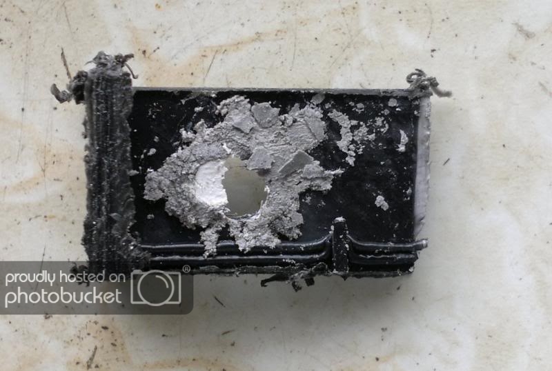

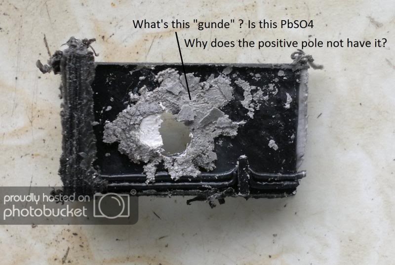

thank you so much for your helpful& interesting knowledge.
Would you please help me to answer these question in the pictures below. Thank you so much !
By the way this is the material of the pole:

Base on the article I read, upon charging the positive plate which is PbSO4 disassociates into PbO2 and the negative plate which is PbSO4 disassociates into Pb. So the S which is sulfur goes into the water or electrolyte and the extra O or oxygen turns into a gas and gets vented off. So originally the positive plate is lead oxide which structurally is weak and this may be why the positive plate or terminally deteriorates.
Normally you apply more charge into a battery than what you get back out through discharge so for simplicity I only considered the charge situation. So in this case inside the battery electrons would be leaving the negative plate through the electrolyte and into the positive terminal.
So normally in the electroplating process or cathodic protection circuitry the positive terminal is sacrificed because electrons are going into the plate while at the same time positively charge ions is leaving the terminal and migrate towards the negative terminal and after the power is removed the ions become deionized and is simply plated onto the negative terminal. Sometimes ions simply stay in the electrolyte and eventually get washed away and you're left with a mess.

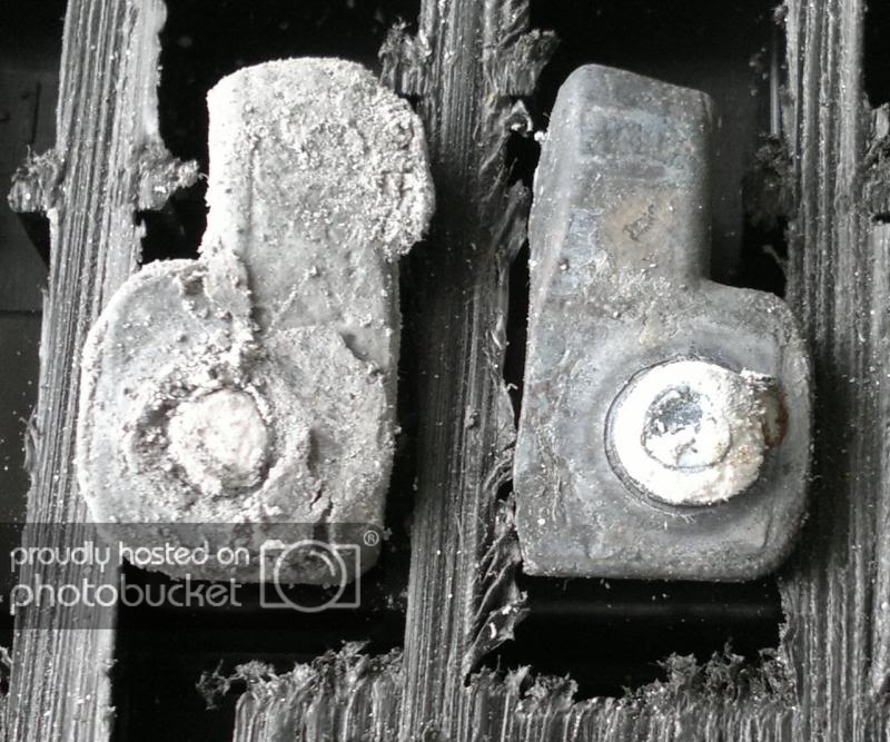

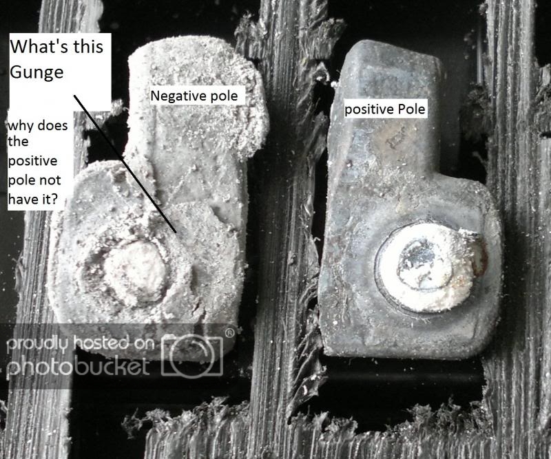

Would you please make it clearer? What's that gunge in the 1st picture ?

Some batteries have lead alloy plates for strength. Batteries for static use have pure lead plates.
In the latter case, the gunge can only be lead sulphate.

Thank you duke !!!
but when we charge battery, PbSO4's turned to Pb and PbO at negative and positive plate, why does PbSO4 still appear on only negative plate

To change from sulphate it is necessay that it is immersed in the electrolyte.
I cannot help more in this topic but there was a good reference included previously giving details of the best way of preserving a lesd/acid battery.
