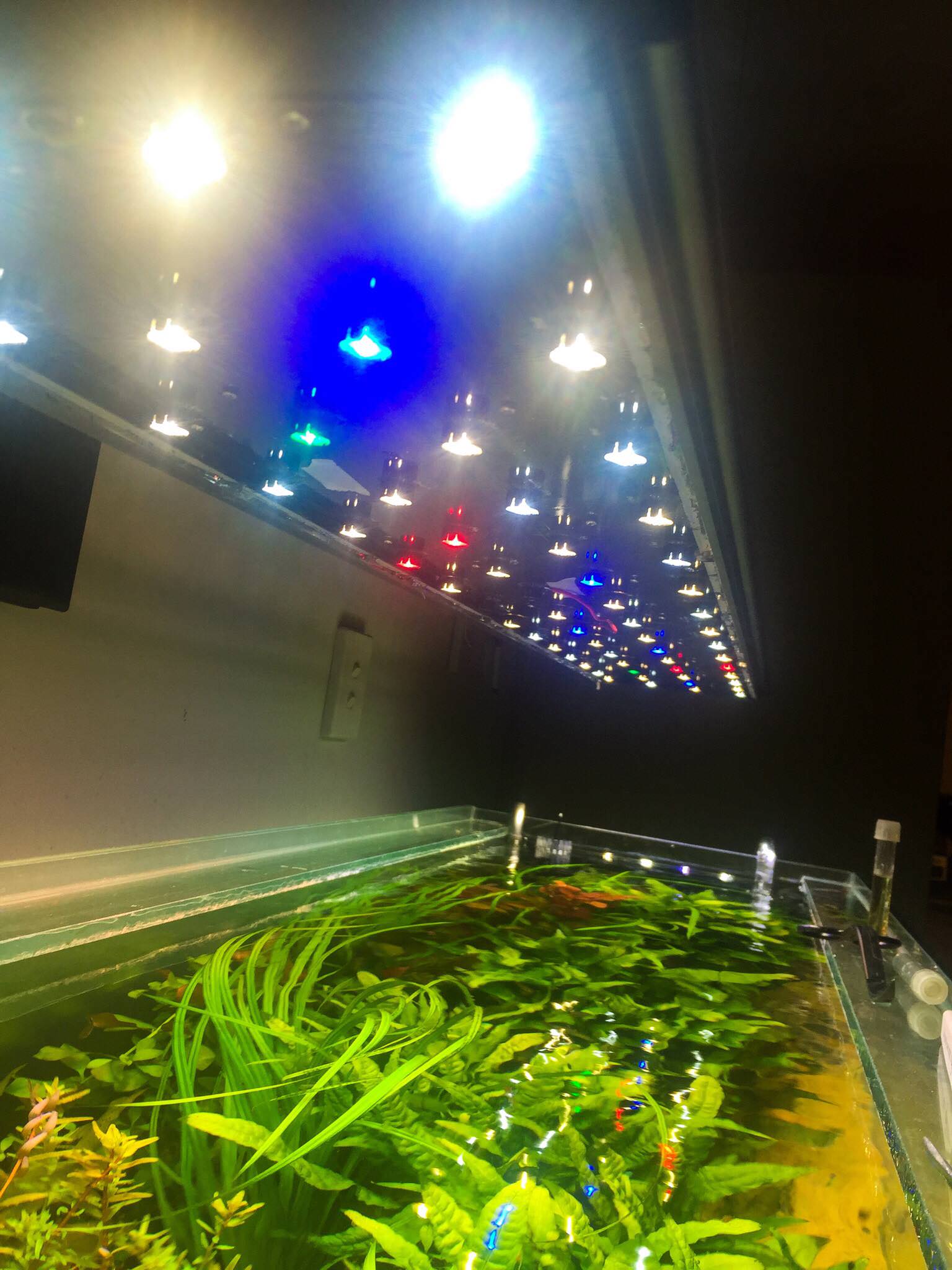

Was given an LED lighthood to use if it could be fixed, trying to understand why it isn't working.

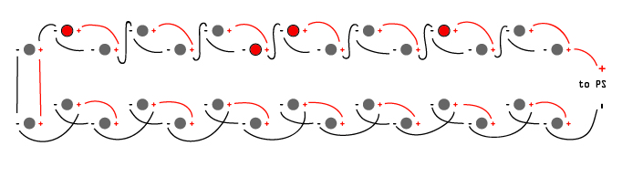

There are 4 leds that don't light up when using the multimeter so I thought they were dead and this was the cause like an old xmas tree lights set up but I went over each led for that channel and they all seem to be connected to the previous one although the wiring seems odd and mapped to two leds then there seems to be a positive to negative from the second to third LED and then the next two are positive to positive and negative to negative. Even when the broken leds were skipped and the previous and next led were tested they gave a reading back using the continuity settings so there appears to be no break in the circuit .

Attached a terrible wiring diagram and photos of the board can be shown if need be, at this stage I am keen to get some advice on how to proceed.
I agree, this is really terrible ;)
At a first glance it looks like + and - are short circuited - which is obviously nonsense. So I assume by the black dots you mean to designate the LEDs and by + and - the anode and cathode, right? This means that there are pairs of tweo LEDs in parallel (red circles) and the pairs are in series (blue arcs):
Ideally you'd replace the faulty LEDs by similar ones. Alternatively you could try and bypass the LEDs with two standard diodes (e.g. !N4001) in series (green). Two diodes to approximate the pass voltage of the LEDs.

Yes that's what I am trying to represent. the red LEDs are the broken ones, although I have tested them with a 9V battery and the first and last lit up but the two in the middle did not so I will start with them.

There is one thing that irks me: Your diagram shows LEDs pairwise in parallel. It also shows only one LED of each affected pair to be defect. The remaining LED should work, although at a higher current, therefore the whole string should work, too.
Or is the power supply not DC (as expected from the +/- markings) but AC? In that case the LEDs in each pair would be connected in alternating orientation and only one LED of each pair would light up during each half wave of the sinusoidal input. Since 3 of the "upper" LEDs and one of the "lower" LEDs are broken, no current will flow in either half wave and the lamp will be dark. I liek to assume that this is the case here:
The the markings +/- are misleading as + for D1 is - for D2 and vice versa.
You now need to be very careful when inserting the replacement diodes: Observe correct polarity!

Just a slight update, when I looked over my amazing diagram again I saw that the two dead leds in the middle were on either side off each parallel set. I started there and bingo that was the cause.

the wiring diagram was from me testing each connection with the multimeter and writing the result down. Plenty of room for error there.
When the dead led was touched the working one in the same parallel set would light up, then when tested with a 9V battery both LEDs lit up in that set but no others and this was the same across the entire board. Again though the two dead ones in the middle didn't work at all

The thing is though, the two wires leading out aren't joined to each other
In your diagram they are, cf. post #2: each pair of LEDs is joined at both ends (one pair = within one red circle), then the traces on the pcb lead on to the next pair.
For one you should not test with a battery without havin some current limiting resistor in series. For a 9 V battery an d a 6.5 V drop across teh LEDs, use a resistor of approx. R = 2.5 V / 10 mA = 250 Ω (anywhere between 220 Ω ... 300 Ω will be fine).
Secondly: if these LED strips are for AC, as I assume and as you confirm by
the wires coming out of it have A+ and AC-
the LEDs should be anti-parallel as shown in post #4. Only one LED should be alight for each polarity of the battery: the one where anode (+) is towards + of the battery. When you reverse the battery, the other LED should light up. If not, the LED strips are driven by DC, not AC and the little + and - symbols are correct This is what you measured.
You should therefore be able to measure a DC voltage at the output of the LED driver (input to the LED strip). By now I think this is the way this is connected. Sorry for any inconvenience my misinterpretation of your diagram may have caused.
This is what I nor think your circuit looks like:
The pairs of parallel LEDs have the same orientation which matches your tests.
This doesn't directly match my idea of the LEDs being antiparallel and thus confirms above circuit.
It sounds like there is an interruption in the traces leading to the diodes. You could try to "repair" this by soldering a strand of wire from one diode pair to the next to bridge the broken trace.

I have attached the wire and bridged the broken gap. light is on the tank and has done well today.
