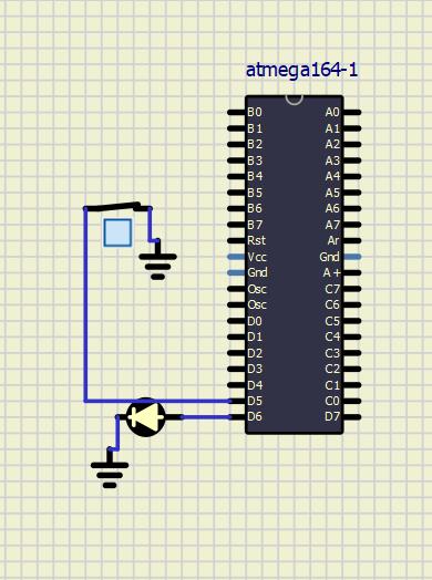

Hello guys, I'm trying to make a led blink at 3 different frequencies, upon successive keypresses. My problem right now it's that it's only blinking 2 times and I don't understand why. D6 is LED, D4 is the test output. Here it's my main function:

And this is how my minimalistic setup looks like:
What am I doing wrong?

You could start with a current limit resistor on series with the LED.
Most uC ports will handle only 20mA.
Anyones guess on how much excess current an LED without a resistor will try to pull from the port pin.
Possibly even damage the port or the complete chip.

You cannot invert a single pin for the LED with a statement like
LED1 = ~LED1; // invert LED
You'll have to do some bit arithmetic like this:
Code:
#define LED PD4 //will be D6 in your application
ISR (TIMER1_OVF_vect)    // Timer1 ISR
    PORTD ^= (1 << LED);    // bitwise EXOR
    TCNT1 = 63974;   // for 1 sec at 16 MHz // not required, I think
(taken from this website).
Your code possibly overrides the input on D5 as it inverts all bits on port D (not clear as I couldn't locate the definition of LED1 in the code) thus setting D5 to "0" which will lead to an endless while loop in main here:

Another possible issue is here:
Code:
// Port D initialization
PORTD=0b00100000; // D.5 needs pull-up resistor
DDRD= 0b01010000; // D.6 is LED, D.4 is test output
For one this should read:
Code:
DDRD= 0b001010000; // D.6 is LED, D.4 is test output
D7 was missing in DDRD= statement. This is not the issue, just for the sake of clarity.
Here's the catch: all other pins of port D are declared as inputs but left floating in the circuit. This leads to unpredictable behaviour. All unused inputs should be explicitly declared as Pull-Up. Or declare the unused pins as outputs.

What I've found is that this code could possibly work
Code:
if(SW1 == 0)        // pressed
           delay_ms(30);   // debounce switch
           if(SW1 == 0)
           {                // LED will blink slow or fast

#define LED1 PORTD.6 // PORTx is used for output
This notation is unknown to me for AVR C programming. Where can I read more on it?
The other remarks about open inputs and missing resistors still are open.

The problem is that when I'm using a switch, if it's on 0 position the circuit it's still blinking...So the switch it's obsolete...Right now it's blinking 3 times but I can't see so cleary if it's 3 times or 4 times.. How can I check this?

Sorry, I don't have time to write the code myself. But you find examples on the internet, e.g. this one.
This is my final code but it's having a really weird behavior... 3 times blinking, then 4 times, 3 times blinking, then 4 times, and so on...

The for loop doesn't make sense.
When you first enter the loop PCR1AH == 0x4C as per declaration at the start of the program.
In the first iteration of the loop (i == 0) this will lead to OCR1AH = 0x13 (first if statement is true).
In the next iteration of the loop (i==1) this will lead to OCR1AH = 0x2F (else if statement is now true since OCR1AH == 0x13 from the first iteration).
Remove the for loop completely, it is not required here.
Also: no need to set TCNT1H=0; TCNT1L=0; every time. As these values don't change, it is sufficient to set them once at the beginning of the program.

Thanks for your help but I've solved in a much easier way:
Code:
void handle_press() {
        int i;
        int state = 0;
int delay[] = { 150, 250, 500 };
  /* blink three times at the rate specified for the current state */
  for (i = 0; i < 3; ++i) {
    LED1 = 1;
    delay_ms(delay[state]);
    LED1 = 0;
  /* then wait another second */
  delay_ms(1000);
  /* update state */
  state = (state + 1);
  if (state == 3) {
    state = 0;
void main (void)
unsigned char temp,i;
char a=1;
    int teamNr = 13;
    Init_initController();  // this must be the first "init" action/call!
    #asm("sei")             // enable interrupts
    LED1 = 1;               // initial state, will be changed by timer 1
    while(TRUE)
        wdogtrig();            // call often else processor will reset
       if (SW1 == 0) {
      handle_press();
}// end main loop
