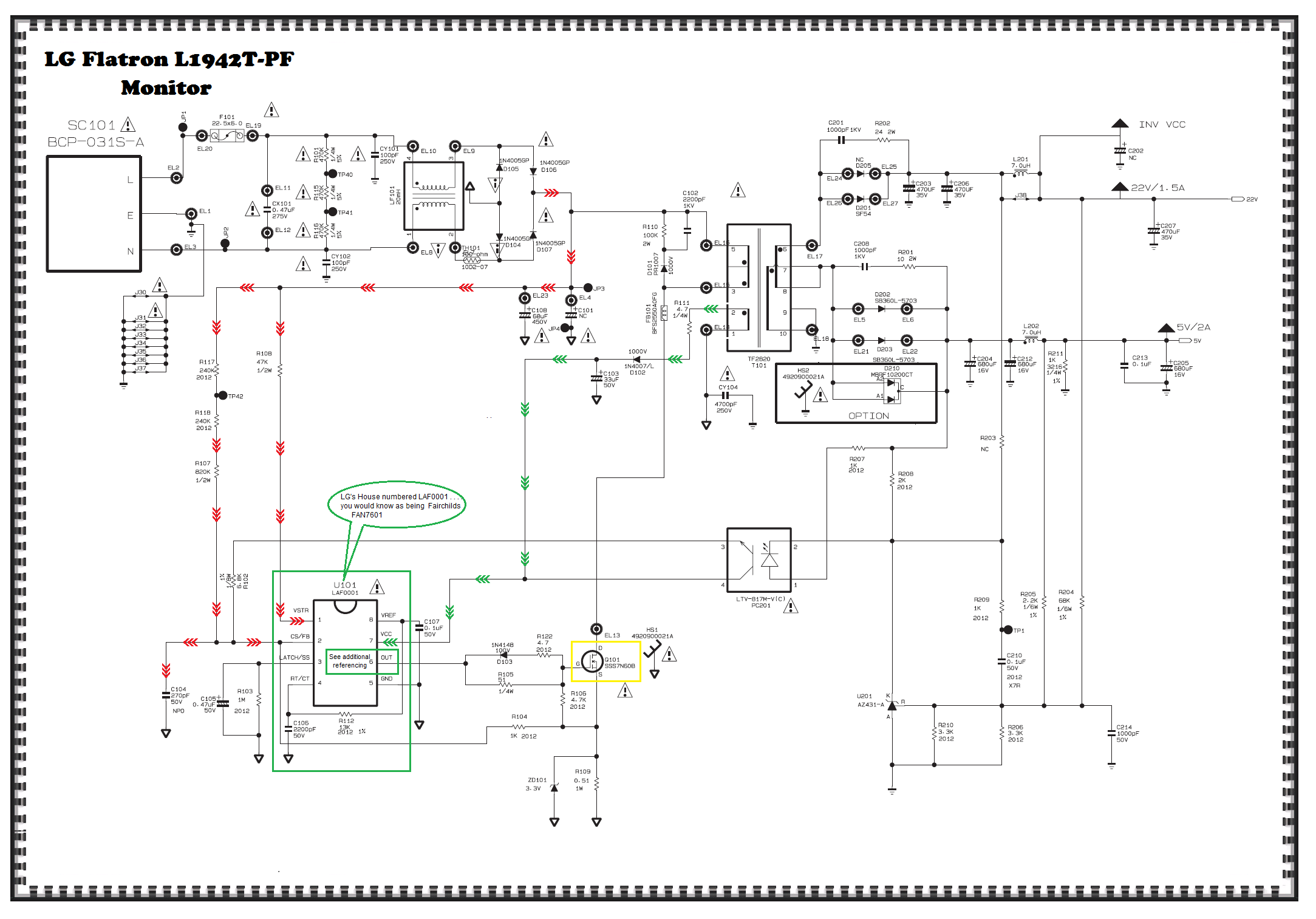

Hi all,
Got this LG Flatron L1942T-PF LCD monitor free from a friend but the problem is it does not have display power (power board model LGP-002L) and lacks a main transistor at Q101. After searching thru service manual, I installed a mosfet SSS7N60B at Q101, replaced all the secondary filter caps. Then I connect a 60W light bulb in series at F101,switched on mains 220vAC power,the light bulb flash a second,then lights off. This indicating there is no shorted component.
FYI, I have a digitalmultimeter(DMM), capacitor meter and a 40W soldering
iron with basic skills in replacing bulging capacitors and revive dead LCD monitors.
First,on the powerboard, I need to be sure there is poweroutput from P201 white connector where I perform DC voltage test by touching red probe to label 5V and black pin to cold ground (screw pad) but see no volt reading(zero volt) on DMM, meaning the 5V standby is not present.
Later on I perform the same DCvoltage test(red probe to cathode) on the following with the corresponding reading:
C101 main cap=286vDC
Q101(middle pin)=108VDC
D102 diode= -109vDC( negative reading?)
D107 diode=109vDC
D106=109vDC
D101=109vDC
D105 & D104= no DC at all
On power IC at U101 it is label LAF0001,pin 1=Vstr,pin 2=CS/FB,pin 5=Ground,pin 7=Vcc Putting my red probe to pin 7,black pin to cold ground yield a DC reading -109vDC(negative?)
The opto at PC201 is label 817C,on diode test,one end on left facing D102 reads "1"= infinite while the other end reads 1335. Is the opto good?
Refer to inverter transformer at T301, I set my DMM to resistance test on 2k ohms scale. Reading on one end (1&2) is 1028 while pin 3&4 reads 1024. Guess the trans is good.
BTW, how do I test if the yellow transformer beside maincap is good with my limited DMM. I also attached some photos.
Hope someone can help me in solving the no power issue. Many thanks in advance.

On your voltage measurements, take note of the central POWER switch mode transformer and then visually draw a vertical line to separate the schematics left and right circuitry.
That circuitry on the left is AC line associated / connected and referred to as HOT circuitry.
That circuitry to the right of the division line is being ISOLATED by the transformer secondary winding and is thereby referred to as COLD circuity.
HOWEVER, you might find a couple cases of the two different grounds wandering over to an opposite side of the board.
But that situation will be for an isolating agent such as a capacitor or high value resistor being connected between them.
Now in your metering ground on the left side of the circuitry, you need to use one of the triangle designations of a HOT ground, when measuring that HOT circuitry.
In your metering of the right side circuitry, place your metering ground to the conventional ground symbol.
(That should explain some of your given "weird / unexpected" voltages that you experienced before . . . .due to cross ground references.)

I now have to see if your power board layout is being like this supplied reference below:
http://assets.shopjimmy.com/media/c...5774693fb5d/s/h/shopjimmy-eay41830902-top.jpg
On the boards top near the U101, I am finding there is being no C104- C105- C106- R112- R103-R102-R118-R117 . . . . any chance that they are being mounted on the other side of the board, as being surface mount
components ?
Waiting for your feedback on that info.

On your post #7, in BOTH cases, you are IMPROPERLY using a COLD ground for your metering ground reference . . . it should be a HOT reference ground.
In the case of the transformer derived supply voltage, which is being derived from terminal winding numbers 1 and 2 of the SMPS transformer T101 and then their diode feed . . . to that mentioned D102.
That voltage supply’s reservoir capacitor is C103 and you do need to note, that its negative terminal IS being connected to a HOT ground.

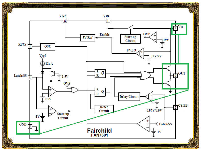

But do note that voltage is not even generated or being available, unless Q101 is being driven to energize T101 power transformer.
That requires a look at my second referencing provided, for the U101 chips internals.
Take note of pin 6 of the unit where you see that the output drive of he unit is being provided by two series arranged transistors that are being directly across the full power supply voltage of the chip.
Normal design utilizes a NPN and PNP transistor in series and is called a “totem pole” output.
In this case they are using two series NPN units due to the more robust reliability of NPN units.
Then,it might be named a “Quasi totem pole” output
The bottom transistor is receiving normal drive from the base drive being supplied by the bottom output of the 4 input 2 output or gate.
While the top transistor is receiving a mirrored drive from the base drive being supplied by the top output of the 4 input 2 outputs nor gate, due to its inverted output. (So designated by the small circle)
Now with this type of drive output, one can have a very HIGH drive level output and both transistors to alternate in the drive signal presented at pin 6.
Then the series R122 and R105 reduce down to the desired gate input level of the Q101.
