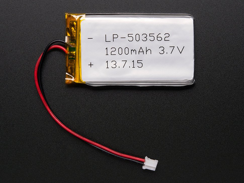

See this illustration:
If of high enough current capacity 1200 mah and of proper physical sizing, this one from Adafruit would be taking the RAW DC you feed to it for charging and any temp sensing is being done ON the small PCB shown at the left side and no need to send any temp sensing back to an off board charger via a yellow(sense) wire.

Hi "73's de Edd,
The plot thickens. Yes, I can see that there is just that sort of mini-circuit-board included into the shrink-wrap envelope of the existing battery, to include two tiny din chips. I tried doing an ohm reading on the yellow-black pair, using a heat-gun, but got consistent zero readings, so it seems likely it likely produces a voltage. But the 3.7v battery is now producing only a few hundred milli-volts, so it might not be powering that wire even if it should. I can measure the charging circuit, and, when powered, that is giving me a very acceptable 4.2 volts. But in any case it seems that running without the yellow simply might not work. The truth is that I already have a replacement device, so I am not toooo dedicated to reviving this defective one. The battery you suggested is about 10x the capacity of the one that is there, which could be fine, but it is about 2mm too thick.
In any case, thank you for your thoughts and suggestions.
