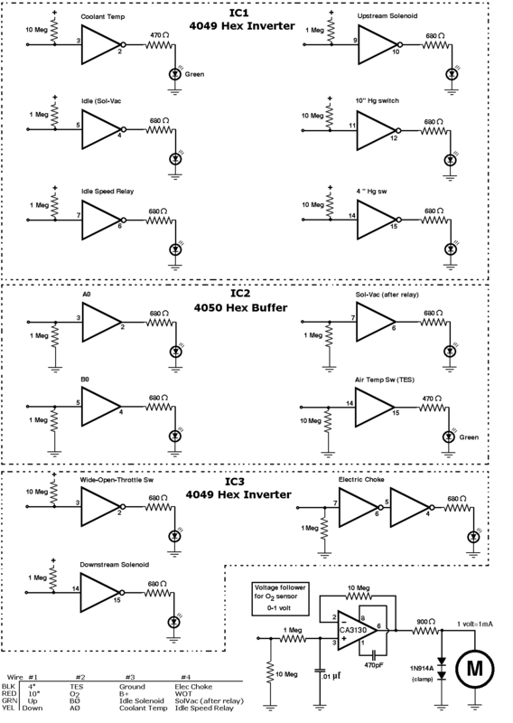

Hello All,
I have two small projects that I would like to make.
This is for most CJ Jeeps in the '80's. Mine is a 1984, Jeep CJ-7.
This is a diagnostic unit that connects to a diagnostic plug that predates the OBD-II.
The simpler version can be found here: http://www.gleebledorf.com/diagtool.html.
This page will also discuss and show you the original posters version of the tool.
Here is the page for the diagnostic connector and such: http://www.gleebledorf.com/diagnost.html.
I have the Molex connectors ordered.
Feel free to reach out if you're you're interested in making this.
Thanks,
Patrick
