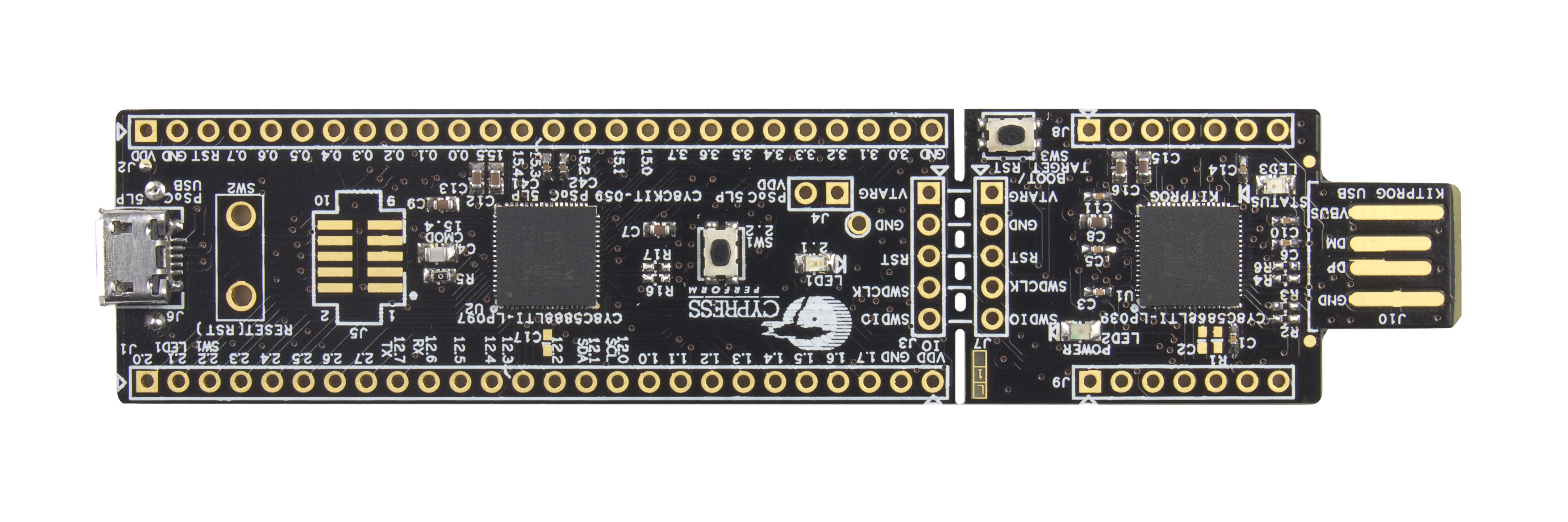

danadak
Feb 19, 2021
1,104
Feb 19, 2021
1,104
A possible single chip approach :
Basically this is 4 channels, a fifth could be implemented with DMA and a table.
I used DDS on chip to produce the clocks for the WaveDacs. It has a phase accumulator
than could be used to FM the DDS with either API call or DMA. You could eliminate
DDS and use general DMA triggered by PWM programmable clocks, I just got lazy. This
would save other chip resources, even though as show you can see in right hand window
many resources left to use.
The DACs are configed as current out DACs, to preserve the 4 opamps for other purposes,
and to effect mixing. Each Wavedac can be switched between one of two waveforms,
arbitraty, sine, tri, square.....
I showed the DFDB (Dig Filter block), you could use it and SAR to apply filtering to composite
waveform. Also show is an onchip mixer component for whatever.....
Other components on chip, many multiple, attached
Board to use ~ $ 15, IDE and Compiler free.
Also onboard a PRS component to generate noise.
In PSOC land terminology "component" is an onchip resource.
You can also burst waveforms, an example here using counters and other logic.
- https://www.edaboard.com/threads/test-bed-dds-and-wavedac-burst-tool.393572/
Regards, Dana

danadak
Feb 19, 2021
1,104
Feb 19, 2021
1,104
epsolutions, not out of your league.
Here I dragged out of the onchip catalog a WaveDac, "wired" it to a pin with a wizard, wrote one line of code,
a start instruction for the WaveDac, and generated a sine. What could be more simpler ?
Its a breadboard full of different parts / components on a single chip.
Each component comes with a lib of f() calls to control the component in real time.
This example next step replace clock with clock + PWM or DDS to control frequency.
Still simple.
Don't underestimate yourself, if you are already programming thats 90% of the battle.
Regards, Dana.
