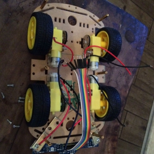

I'm building a Arduino based Robot car which is controlled by both Brain Waves & Infra Red. It is 4 wheel drive with line following sensors & a ping sensor to (hopefully) enable it to be autonomous. I'm also hoping to fit an lcd touch screen.

and how do you plan to "mind" control it ????
I've bought the NeuroSky Myndplay kit which works a bit like a ECG & reads your Brainwaves. It then transmits this to the robot via Bluetooth & a dongle which the Arduino & Raspberry Pi boards can understand. If you read 'Making a Mind Controlled Robot' by Tero & Kimmo Karvinen, that will explain better. Believe me, I've already had a lot of cynicism from people saying it can't be done & it'll be too hard, but I trust the literature & I'm the type of person if you tell me I can't, the more I'm determined.

Have you done any basic testing yet, or do you plan to just dive straight in with the car?

I am basically learning as I build it! It's my first project, so i really HAVE thrown myself in at the deep end! I've downloaded & been reading SO many books on the subject & I'm hoping to get helpful tips from people on here. The main problem I've got at the minute is that (due to Sod's law) my laptop has just decided to stop working!!!!!!!!! So I need to get a new one before I can do any programming! I'm well aware it's going to be hard, but I'm up for the challenge.

I'm looking forward to seeing how you progress on this. When the budget allows, I might well buy a Mattel headset too, and have a bit of a play. I'd never heard of them until I saw this thread, then did a bit of extra reading. ('Mind-control' - I thought you were dreaming! :rolleyes:)
I'd recommend making up a simpler test-circuit or two first, though, before tackling the full car project.

EVERYONE I've mentioned it to has said the same thing. But, I've bought a headset (only cost me £80 off eBay) & I can vouch that it DOES work! As for connecting it to the robot, I haven't ventured THAT far yet, I'm taking it in stages. I've read tho that as far as a Bluetooth dongle, the 'Bluesmirf' dongle is designed specifically for the NeuroSky headset. But I've also read that you can buy cheaper Bluetooth dongles & hack them.

Aside from test circuits, for remote communications, I'll probably use an APC220 module. I have heaps of those just sitting here. They're fast enough for anything I'll do while playing with the idea. (I won't make a car - I'll test the 'mind control' concept for other remote control projects.)

And for a controller, I'll use PIC rather than Arduino or Raspberry Pi, since I'm already familiar with PICs and have plenty here already, in a range of flavours.

I was the same when I first saw the book title 'Build a mind controlled robot'! I thought there HAD to be a catch somewhere. I'm using Arduino because all the literature I've got is about Arduino & Pi. I'd love to know more about the systems you're talking about though. So any pointers you have to educate me on that level will be well received. Thank you for your input.

I've never even touched an Arduino, but from what i've seen they're a good beginner's tool, but not really suitable for serious stuff. They're more of a development board. The advantage of raw PIC, Atmel etc is that they are just a chip, and you add exactly what you need for your purpose. Not sure about Atmel, since I've only ever used PICs, but PICS come in 'through-hole', so are easy to mount on a simple PCB. (Suits me perfectly - my poor eyesight isn't good enough for working with SMD devices.)
Like Arduino, PICs can be programmed using C, so the learning curve isn't too high. I have a C compiler, but generally don't use it. I use the PICBasic Pro compiler from Micro Engineering Labs. It uses a form of Basic language, PICBasic, developed especially for the PIC microcontrollers. Very easy to use, and supports driving LCDs, serial communications, (with or without hardware serial ports), USB, etc, etc. Here's a link to the manual if you want to check it out:-
