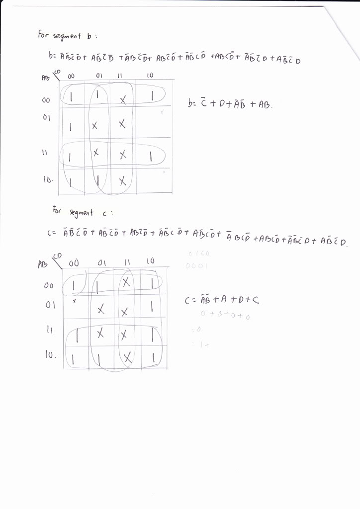

Hey guys, currently I am working on to find the minimize logic expression to lights up each individual segment in 7 segment LED
For segment a : B +D + A(bar) C(bar) + AC
For segment b : C(bar) + D + A(bar)B(bar) +AB
So far correct ? Can anyone provide me for the the next few logic ? want to compare my answer.
Thank you

The homeworks section doesn't work like that.
You provide the answer and we can tell you (hopefully) whether it is correct or not. And if not guide you along to find the right answer.

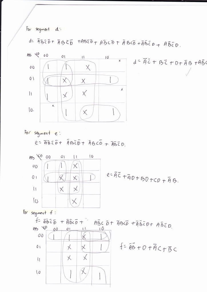

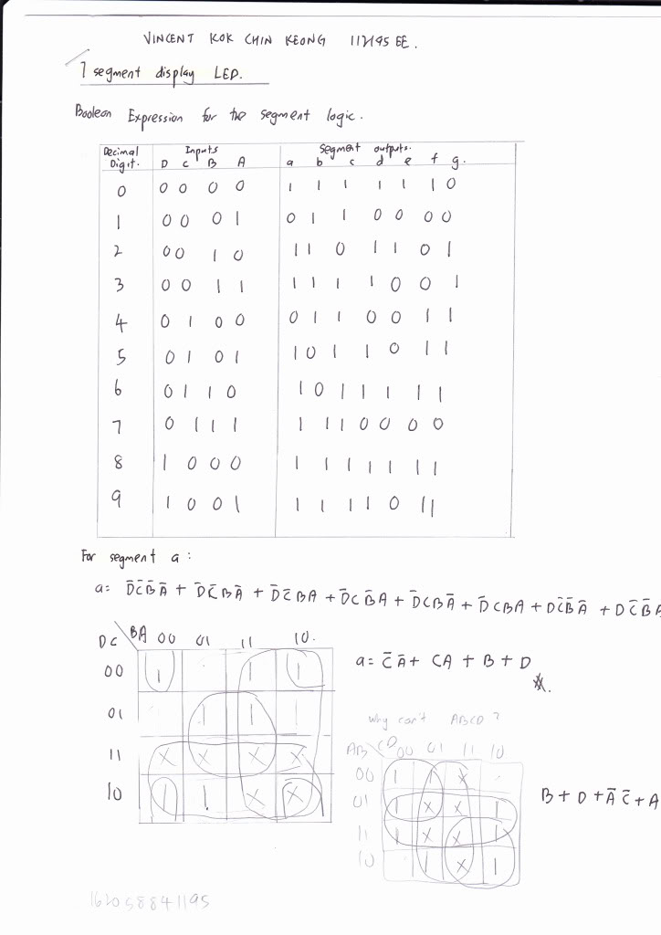

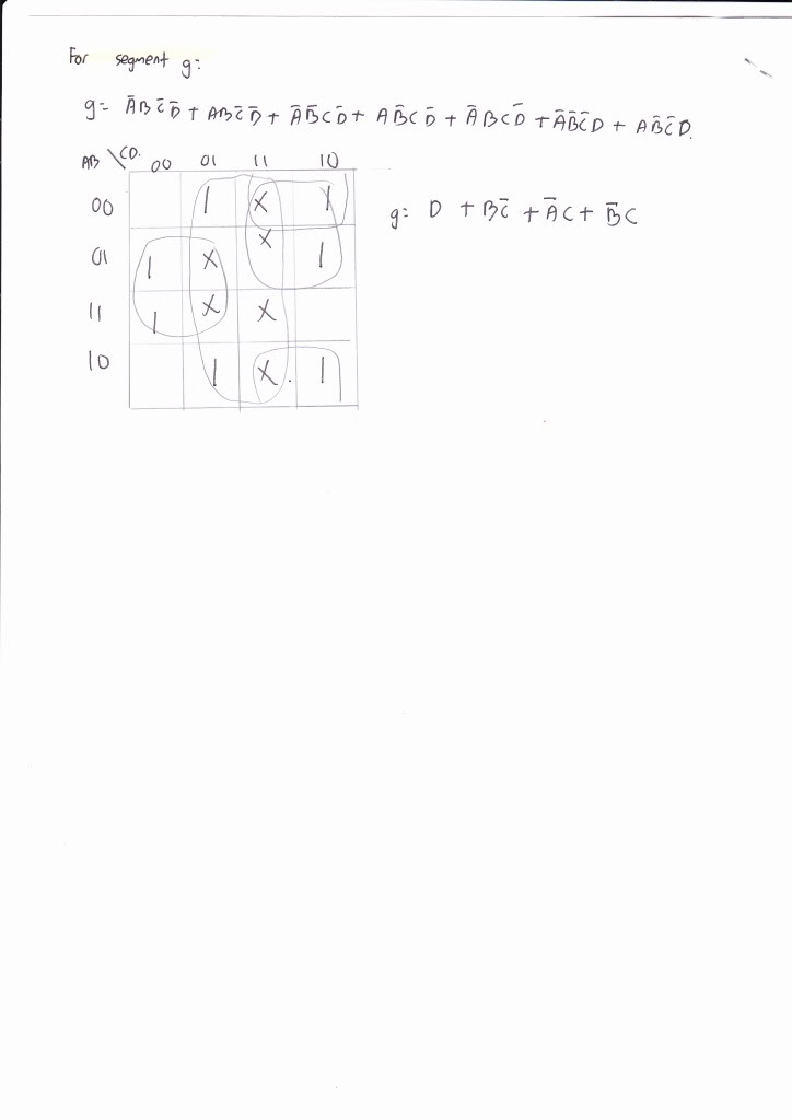

This is my final answer. Correct me if I am wrong :)

For reason of little time I checked only sheet one for segment a. It looks entirely correct to me.
There is a second approach: Look at the KV diagram for segment a again. You evaluated, correctly, the situations where a=1 (or a=x) to arrive at an equation with 4 terms. What happens if you look at the same diagram but this time watch out for a=0? The equation will have only 2 terms, at the cost of each single term being more complex. From the equation for a=0 you get a=1 by negating the complete equation.
Note: this is only a hint for an additional solution and shall in no way imply that the solution you found by yourself is not well evaluated.
